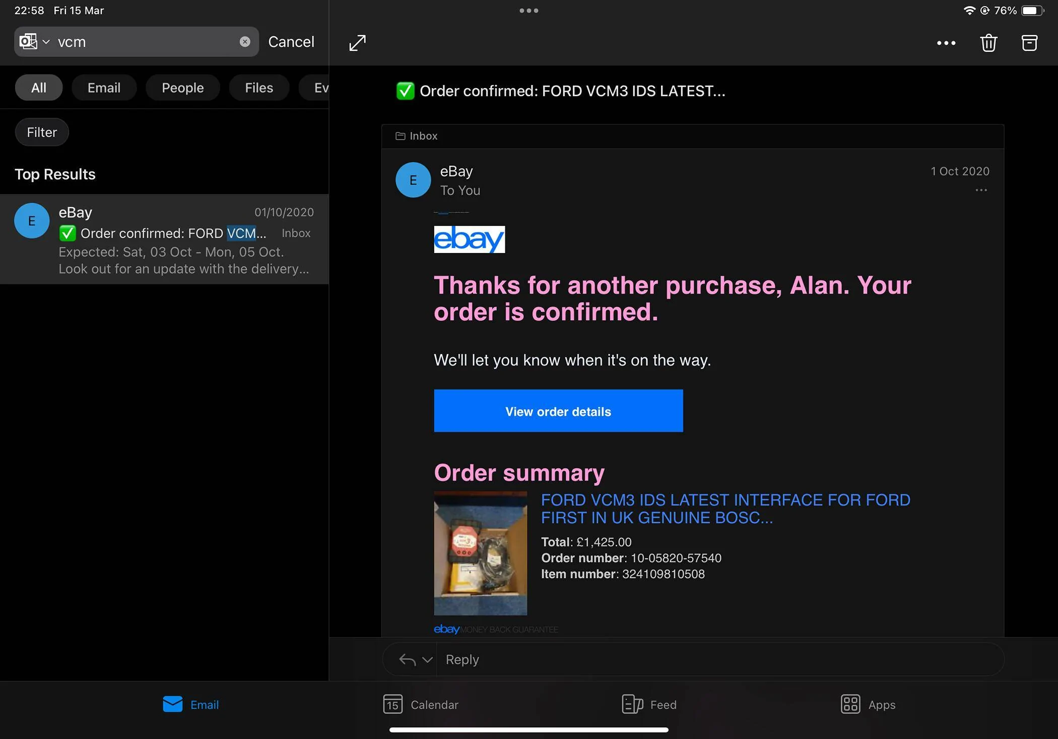

I bought mine from eBay when they first came out. They’ve now doubled in price.
