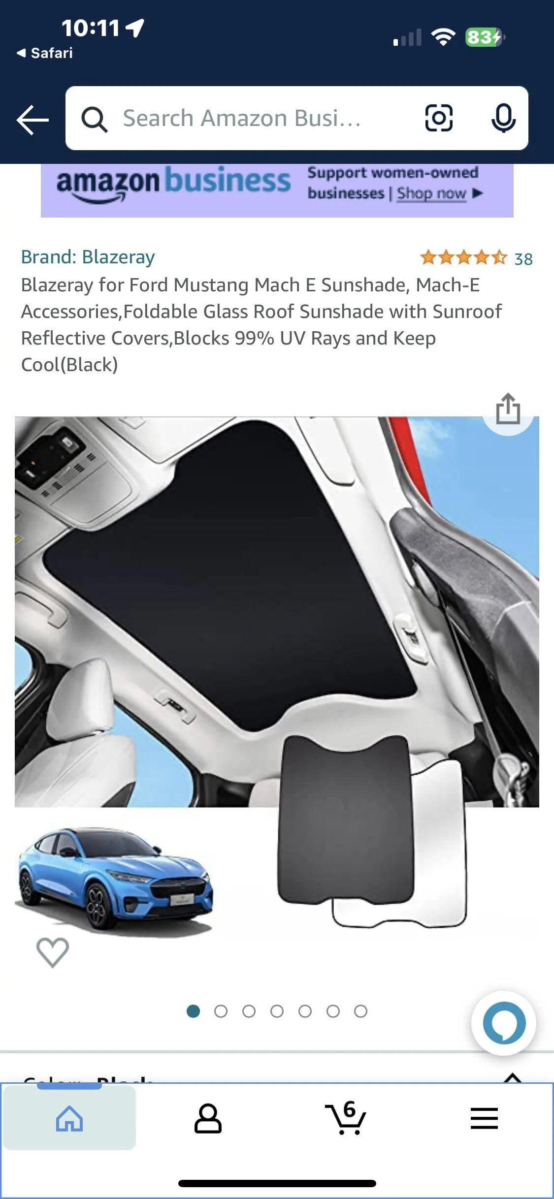

The roof glass is supposed to get hot, that's what the UV glass does. That's literally UV energy that is being stopped at the roofline and not coming down into your car, heating up the interior. The glass absorbs that energy, heats up, and radiates it back out. Most of it radiates upward, though you get some heat transfer into the cabin through conduction, it's fairly minimal. Same goes for a solid roof, cloth covering, or extra tint.
I wanted to believe that I didn’t need to put a snap and cover and when I parked, but I found out that’s not true one day last July I parked the car in my driveway for eight hours without my covering the starting temperature in the interior was 88° in eight hours later the temperature was 161°. The next day when the temperature was exactly the same I did the same thing with my snap in cover covering the sunroof and when starting the temperature was 90° and eight hours later the temperature was 129°. That’s a 30+ degree difference using the cover when the car is sitting in the sun and not moving and that makes a big difference when you start up cooling your car and using your battery that’s my findings in the state of Arizona in July in the sun, with an accurate digital reader, on the same conditions in the same position Two days apart
Jes sayin
ripperAZ
Ripper
Mar 4, 2022
724
949
AZ DESERT
2022 Ice White Mustang Mach E AWD EX BATT
Here’s what I’m talking about. It’s called the blaze Ray and if you’re in Arizona, you really should have one because if you don’t think it’s getting hotter I’ve proven it is. It’s not a tint. Especially when you’re parking because that tinted panel gives off heat better when the car is moving but not so much when it’s sitting It keeps your car cooler. It makes it darker inside for the gauges to look better and it also prevents people from looking at stuff in your car and wanting to break in and there’s no reason not to have one.
