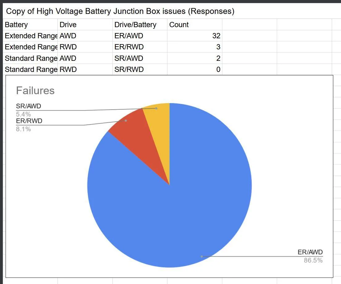

So is there any indication about which cars 'may' be affected-ie RWD, AWD- SR, or ER. I fancy the type of car you have may be an important factor...
A completely unscientific poll strongly suggests that the more power your Mach-E is capable of flowing through the contactors, the more likely it is to suffer a failure. Thus a rear wheel drive, standard range Mach-E is least likely to suffer failure while an AWD, extended range unit is significantly more likely, and a GT (dual large motors, extended range pack) is most likely to suffer failure.
Also, per official Ford communications with the American public, via NHTSA (the agency tasked with regulating and enforcing U.S. transportation safety standards), risk of contactor overheat failure is increased during DC fast charging and "repeated wide open pedal events".
