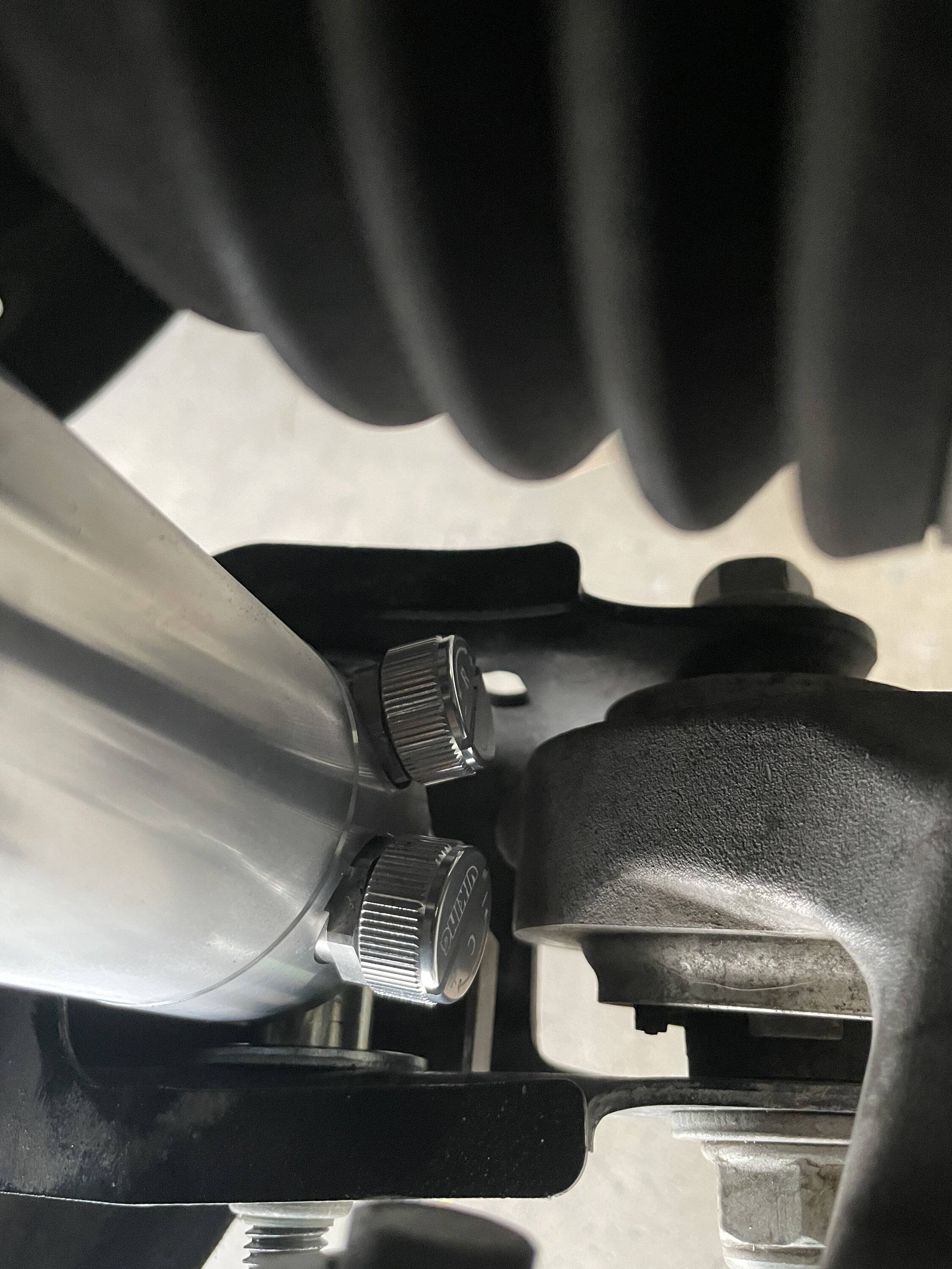

Stock 19's with AS3's The AS3's were about to let go on that corner but the sway bars helped keep it planted. GT wheels and tires soon. But I don't expect a night and day diff with them. If they were Pilot4's or the Scorpions Mark mentioned maybe.
Currently any adjustment 0-13 can be done by hand quickly. I have a packing blanket I keep in the back of the car. Pull over somewhere and can roll with my finger either knob on either shock. Once you get up over 13 the knob becomes harder to roll and requires a bit more work. I have rolled them up to 18 but 17 and 18 clicks were killing my finger.
Here's a top down image of the knobs.
Ford Mustang Mach-E UPDATED: Replacing Rear Shocks: Reducing the rear end bounce. IMG_4182.JPG
Note that little nub on the arm pivot, put dents in my single adjusts because the knob on those are centered. I was also lucky enough that Summit knocks $58 off my latest shock purchase. Had they done that the first time around I would have had duals from day one.
I'm still playing with it but am quite happy with the results. Picking my wife up from the airport. We'll see if she says anything.
