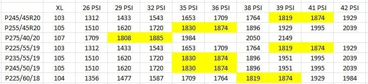

FYI on load and inflation of tires the 255/45/20 has a higher 105 load range and to support the same weight as the 245/45/20 103 it should be inflated to 35/36PSI. So Yes 39psi on a 255/45/20 is actually overinflated for the MME
Here is a chart highlighting pressure that will be optimal for a flat contact patch. The chart shows how much weight in LBS a tire will support at a certain PSI this is how car manufacturers set the tire pressure.

It’s worth noting that Anton’s tires are wider than stock. Given the same rim dimensions as stock, that would require a lower pressure to maintain proper tread contact with the road. ??
Correct Steve. I suggested to Anton to lower the tire pressure from 39 psi to 36 psi since he has 255's instead of 245's. At 36 psi the 255's have about the same load carrying capacity as the 245's at 39 psi and better contact on the road with a less harsh ride. I am currently running 255/45's front and 285/40's rear so my tire pressures are 36 psi front, 32 psi rear.
Edit: I just saw Brian was replying the same time I was with the same info. ?

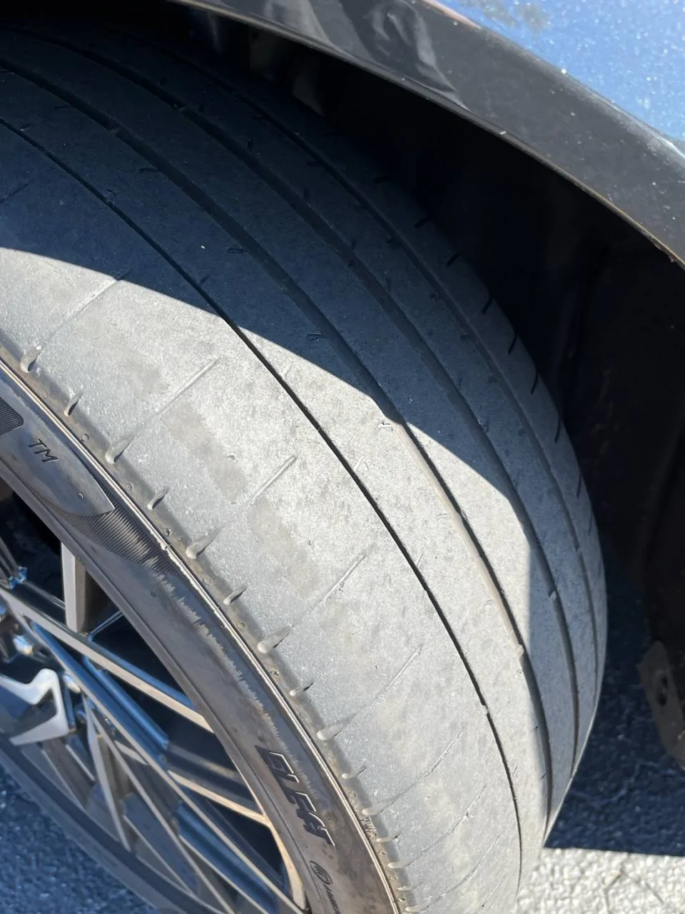

I keep mine at 36 and at only 6000 miles the edges of my tires are almost bald:

Keep in mind that lower pressure will also affect how the tires wear.

The GTPE tires are rated as 220 treadwear. There's no saving them. THat's why I skipped the P-Zero's from the GTPE. At least the stock GT Conti's I'll be running shortly are a 480m treadwear. The GTPE tires have to wear fast to produce the grip they do.
If you look at the middle of the tire you'll see those are down to 4 or mayne 3/32's Which are super close to 'replace me now'. At 3/32's most tire shops won't even touch them.
6k miles isn't good, but not that ridiculous for a summer tire if you've been driving 'spiritedly'. I'd expect about 10k-12k out of any high performance summer tire.

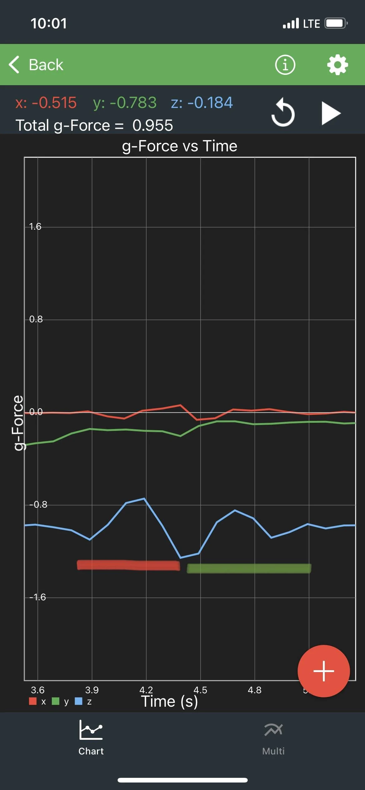

The freeway data you shared almost looks like you had the car in resonance. Especially if it only gets bad at a specific speed. You don’t want to tune shocks in resonance because it will make the ride bad everywhere else. Tune them to feel good on a random/occasional bump.
Yes some of those spots are resonance. Which I thought we were trying to help solve for. I'm no stranger to suspension tuning but I was using those as 1 or more of my trouble spots. Trying to find the best combo for the mix of issues I drive on a daily basis. Some of the areas I've driven well over 22,000 times in the last 11 years. I have bumps memorized.
I did just notice yesterday the physics app was set to 1 second polling. That's not fast enough for some of this stuff. And i still don't have a way to display it worth anything.
However in running around I found a speed bump to hit. I turned off 1PD as lifting will cause the nose to dive and mess with the numbers.
The Thin Blue line is the vertical movement seen from the console at the charger.
The thin red line is side to side movement.
The Thick Red line is just the rear tires hitting the speed bump at about 5 mph
The Thick Green line is the car reacting from the speed bump. Read left to right as normal.
Ford Mustang Mach-E UPDATED: Replacing Rear Shocks: Reducing the rear end bounce. IMG_4263
This is 4c/11r More to come but meetings today might kill it.
Yes those stock GTPE tires are not designed for longevity and you have given good accelerated example of under inflation. If you want to stay at 36psi when you replace do the 255/45/20. That size will wear normally at 36psi.
Agree but it also depends on the type of roads being driven on. Anton drives more on the highway than mountainous roads so he wouldn't have as much wear on the sides running his wider tires at 36 psi. Not to mention, his Pirelli all season tires have a wear rating of 500 which is much higher than the Pirelli summer tires on your car. There are so many factors when it comes to tires and tread wear.
It’s terrible.
I got 15k out of my summer tires on my 450 hp Chevy SS sedan.
Hell, I got 8k miles out of my Nitto drag radials on my 450 hp 2002 Trans Am.
I do still have life in these tires, but not much. 95% city driving, but still pretty bad.
Mach1E
10,513
13,300
That’s fair.
But it still will “affect how the tires wear.”
It won’t affect it as much of more highway. But the wear rating won’t change the kind of wear, it’ll just change how quickly it wears.
Either way, lower psi will make the sides wear more quickly than the middle.
Less noticeable on street tires, but I learned this lesson very quickly when using drag radials on my daily driver.
I had to run super low psi (20) to get them to wear evenly. But it almost doubled the life. People running 25+ psi only got 4k miles or so out of the Nitto DRs.
