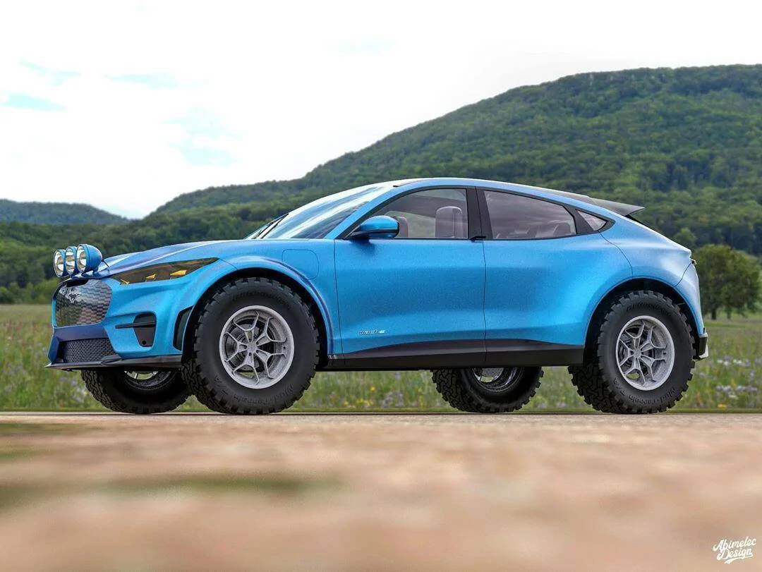

I appreciate the time and thought you’re putting into this.
So what I’m hearing then is still not “impossible.”
We just need a 4” suspension lift kit to turn this into a “real luxury SUV!” ?
Only kinda kidding. Because that in theory could be done. The lack of travel makes total sense along with our lack of ground clearance and short stature.
Ford Mustang Mach-E UPDATED: Replacing Rear Shocks: Reducing the rear end bounce. C5948BC0-BEE5-48A6-A2CD-74AE28250787

The 2.5 inches of travel the Premium has, the 2.1 inches of travel the GT has vs your Lincoln with probably close to 6 inches and air or magnaride. Not even close to possible to create suspension travel where it can't exist. Remove the battery and you can double the length of the a-arms and get your plush suspension. But the way this was designed it doesn't have the geometry required for it. We have less suspension travel than an 80's go-kart and the weight of carrying a pair of jet ski's in a Camry.
We're in the range of a firmly riding Civic, at best.

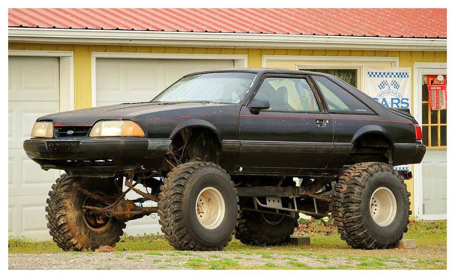

FWIW, she doesn’t have the air nor mag ride. Just the base regular shock suspension. But the travel difference definitely makes sense on why we are so limited.
Time to go to the junkyard to look for an old Mercedes S600 sedan we can steal the suspension from!
Edit: a lifted suspension is definitely possible:
https://www.macheforum.com/site/thr...fted-disguised-suspension-raptor-mach-e.8147/
Ford Mustang Mach-E UPDATED: Replacing Rear Shocks: Reducing the rear end bounce. 5DF626BE-0B77-47D1-BE35-C44F465B7B22

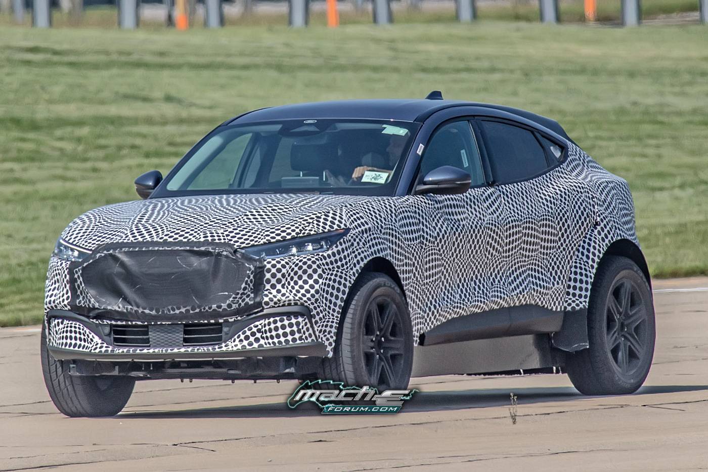

And I’m the loon (I’m not saying you said that, but in general) for saying the Mach-E is #NotAMustang. Mustangs don’t resemble Lincoln’s in the ride quality department.
For sure.
But isn’t a “Lincoln version” of the Mach E on the planning table still? Can’t make a Lincoln without a Lincoln ride quality.

There is a electric Lincoln already. Probably on the MEB platform.

For sure.
I for one cannot wait for the Lincoln version. I would think it will be based off the Mach-E but I've never been able to find any hard specs on the Lincoln Star yet. While I am sure it will be a better riding car then the Mach-E, I highly doubt it will be an Aviator ride but maybe they can get close if raised up a bit which is entirely possible.
