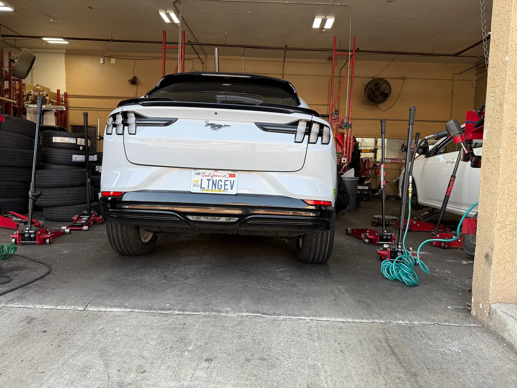

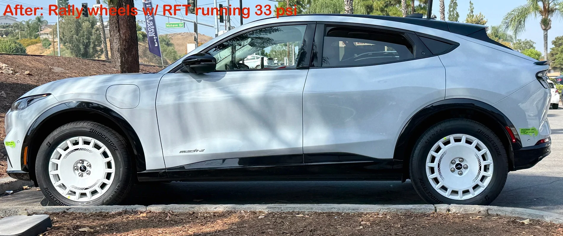

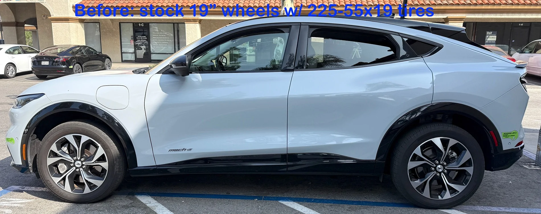

As Mark said, there are many ways to change the ride and everyone is different.
I came from BMWs from 1990s that had gocart handling, stiff ride, steering you can feel, and "magnetic tires" that stuck to the pavement.
I am NOT the type that prefers the latest generation BMWs with soft, cushy, numb steering, and floaty feel.
Thus, my "recipe" that works for me:
  • OEM shocks,
  • Eibach lift springs (+1.5"),
  • Eibach anti sway bars front & rear,
  • Rally wheels w/ 255-55x19" Bridgestone Alenza tires (RFT).
  • 33 PSI.
Now my ride is about 2" taller, tires are massively larger (compared to OEM), Rally wheels changed the entire look.
Ride is so much more like the BMWs I used to drive 20 years ago - very much now a "Sports Activity Vehicle" that BMW coined.....
Thanks so much @markboris for all that you do for us in the community!
