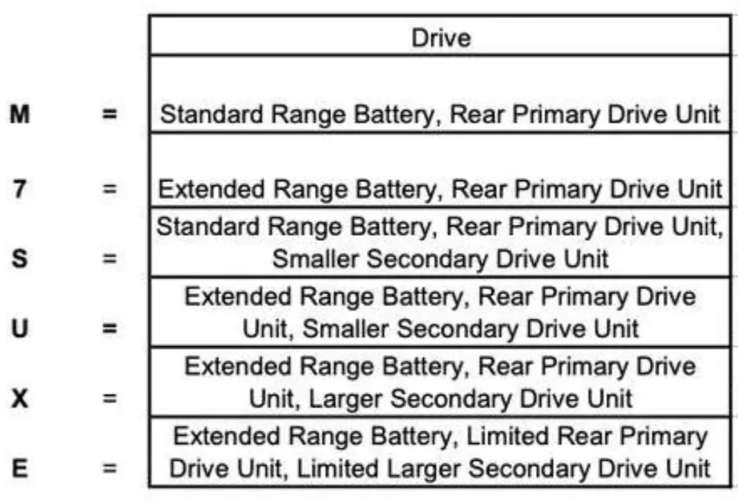

8th digit of your vin should be an X. Plus all 25 GT's should have the extended range battery.
If the 8th digit of the VIN is an X, U, E or 7 it is an extended range battery.
VIN 8th digit code:
Ford Mustang Mach-E What is a 4X? Screenshot 2026-07-14 at 5.38.41 AM
