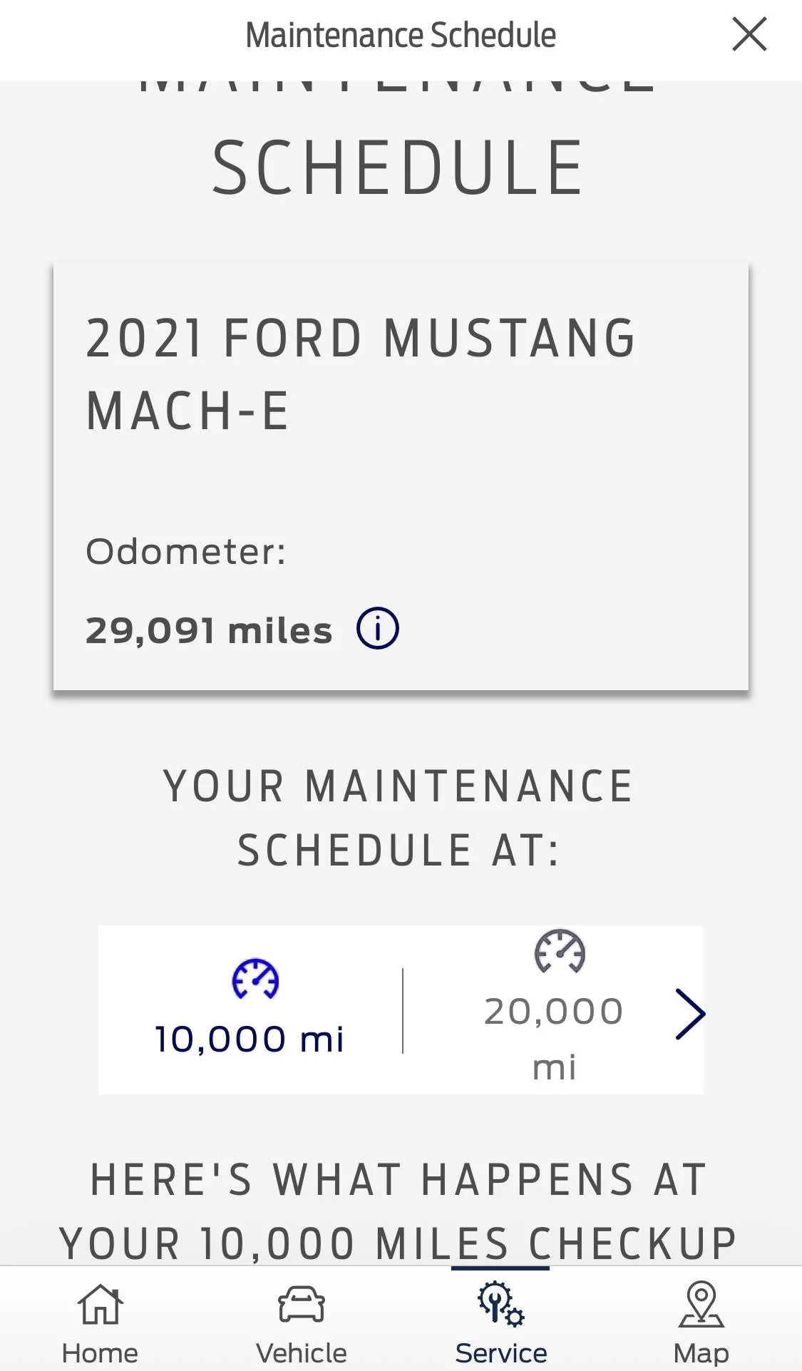

Service schedule is also in FordPass.
If the service tech is diligent, he (she) will notice slight tire wear during rotation and suggest an alignment.
Ford Mustang Mach-E What maintenance does Mach-E require? IMG_3460
