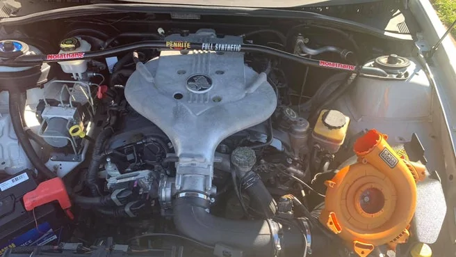

no CAI, no headers, no SC, no bigger turbo, no downpipes, no catless exhaust, etc. All I can think of this wheels and tires at this time. Like I said, I am mentally ill and seem to need to fool with everything.
Crap. So my forced air induction isn't going to work. Damn.
