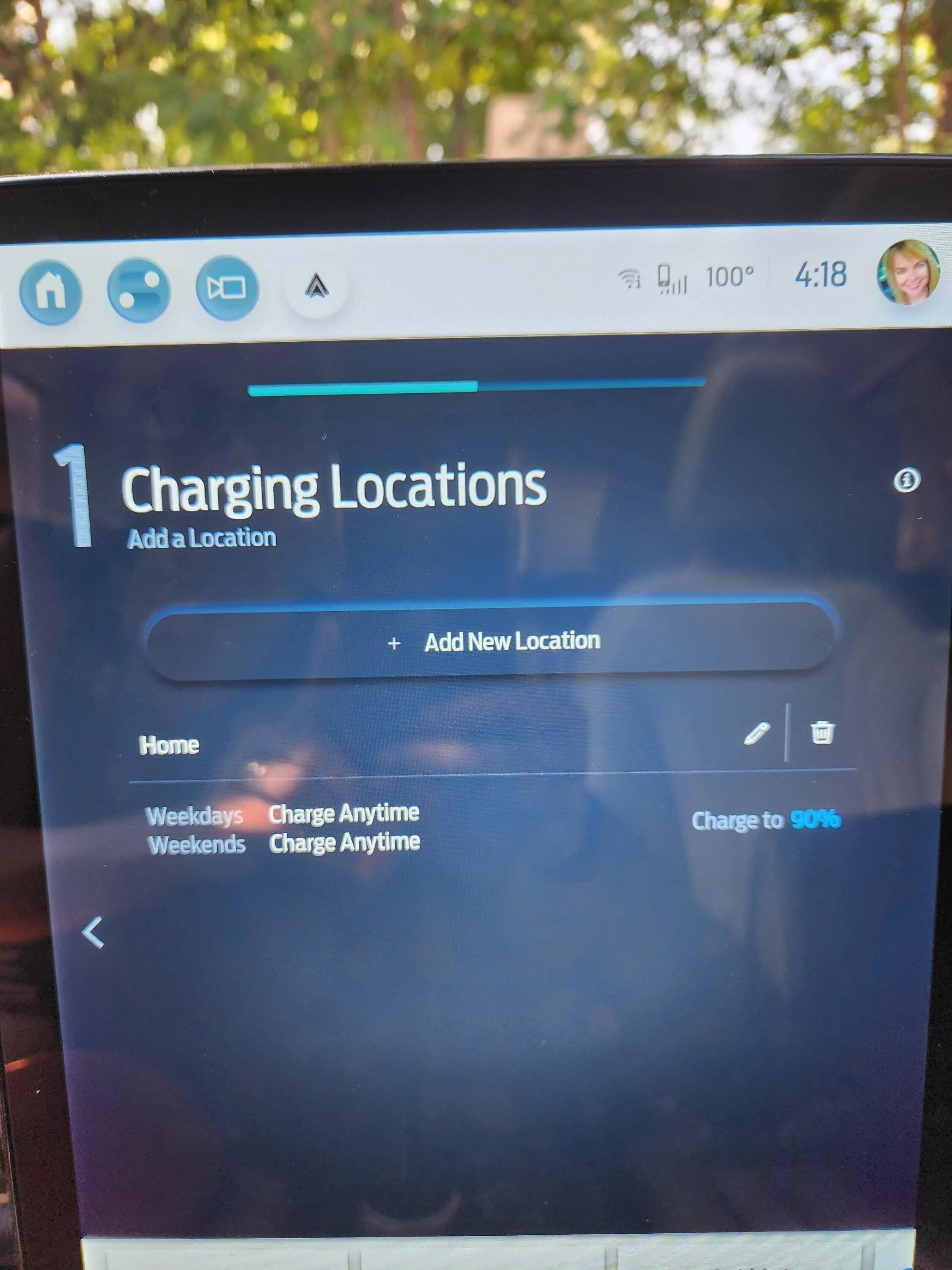

I have been leaving my car plugged in since it has been 104 for several days. I had it set to 90% charge. I got an update 2 days ago. Today when I got in it had charged to 100%. Under charging locations for hone it still shows charge to 90% but on main charging screen at the top it says "will charge when plugged in" I don't see where to choose "preferred charge settings". Thanks for your help :)
That update trigger the 100% charge, everyone experienced that.
You have to go into Charging, and for your location it will say "Charge when plugged in" or "Use preferred charge settings".
It may still be set properly.

This is what my screen shows. I don't see where I can choose "use preferred charge settings". I must be missing something. Thanks for helping a sometimes technology challenged woman. ;)
That setting is now only in FordPass. At least that’s the only place I can find it.
