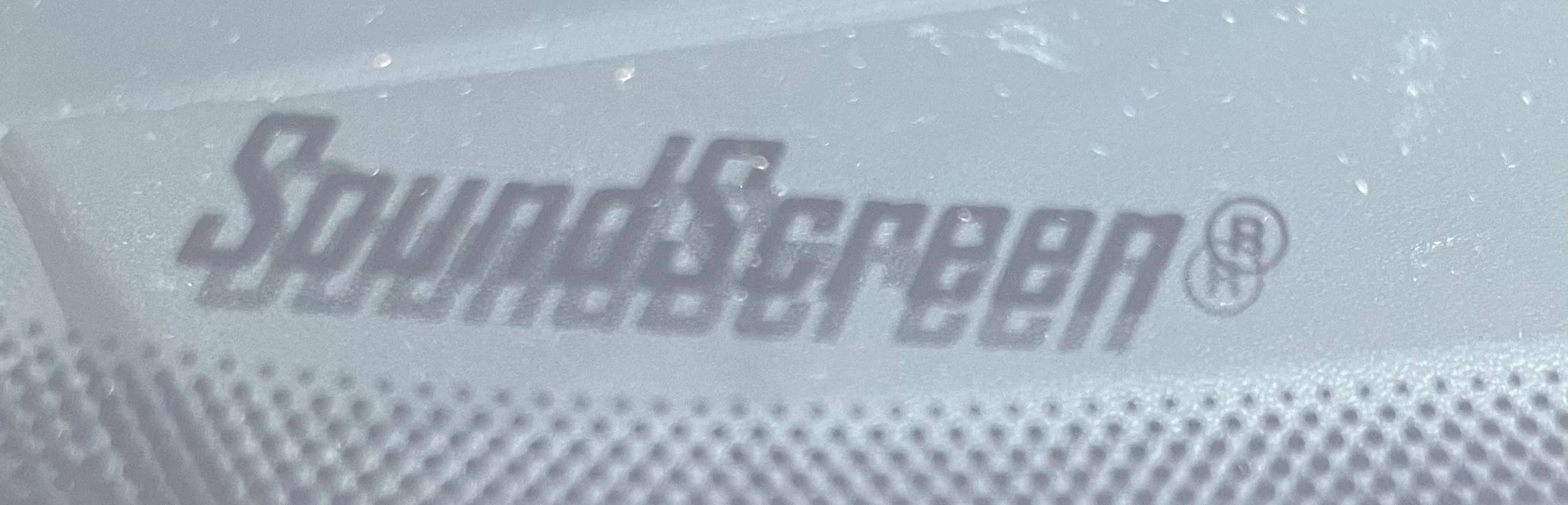

Also, OEM windows have SoundScreen cut cut down on outside noise.

The soundscreen is something I don't want to lose but 99% of my driving is around town and is it worth $700?
