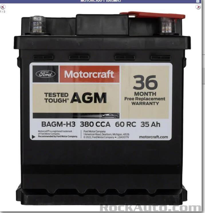

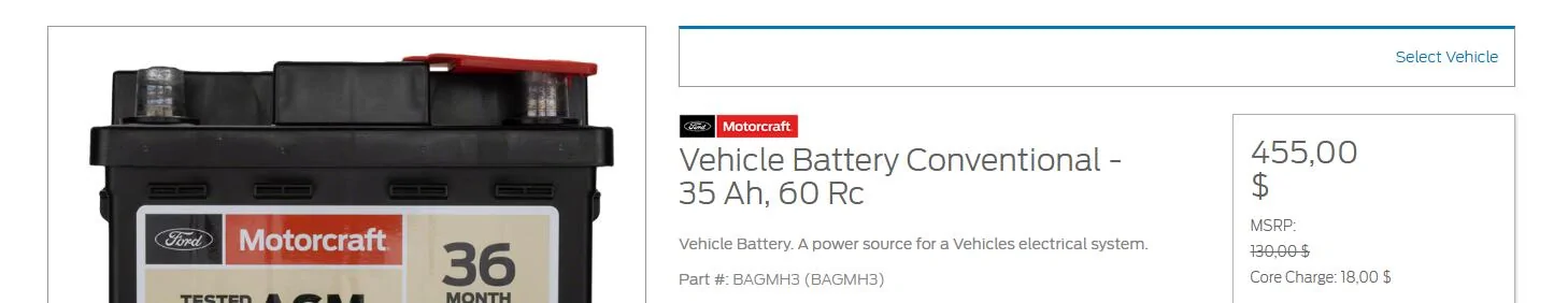

Can you see if i bought the right one? was 455 on ford and on the site you suggested was for 100 bucks lol
Thanks
I paid $180 with labor for replacement via ford mobile service. I’d return that

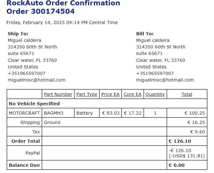

Was $126, sorry. But very good price to me, will come to Portugal and i have afraid that cant enter in a airplane, just now i thought on this
Dude, I would not share that information on the Internet. Your address, phone, email. Identity theft is a real problem. Just trying to help...
