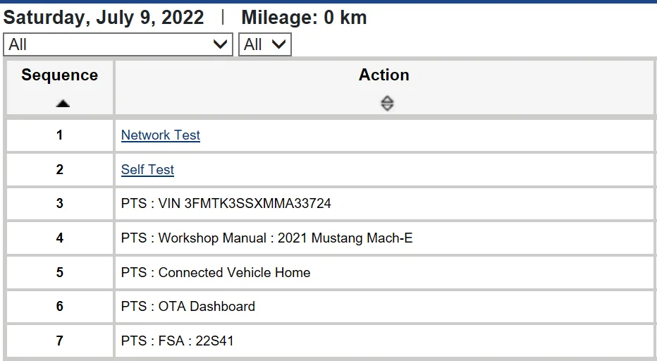

Same situation as @agoldman . They connected with FDRS, 22S41 updates were not available, so they closed out the recall without updating anything.
BECM: NJ98-14C197-AB (AE is 22S41 version)
SOBDMC: LJ98-14G069-AXG (AXH is 22S41 version)
Such a mess ... I wonder how many people will have closed recalls without the software actually on the vehicle and if the OTA system will catch it.
WTF, really? Damnit, that means I have to go in again or hope for an OTA before my road trip in 3 weeks. The dealer didn't mention any of that to me when I picked up the car :(

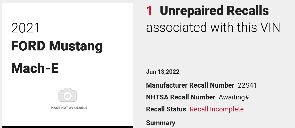

I have a feeling that we're gonna see the updates return today / tomorrow.
Then we're gonna have to figure out what changed...
I'm gonna guess it's a persistent DTC now.
This should *in theory* help owners get the service and parts replaced instead of dealers just clearing the codes and sending people on their way.
Yes, but I have no confirmation that's the change. It's purely my guess. I'm certain they changed something and given the quick turn around I assume it's something small. It could also be tolerances but I would assume that would have a lengthier testing process.
