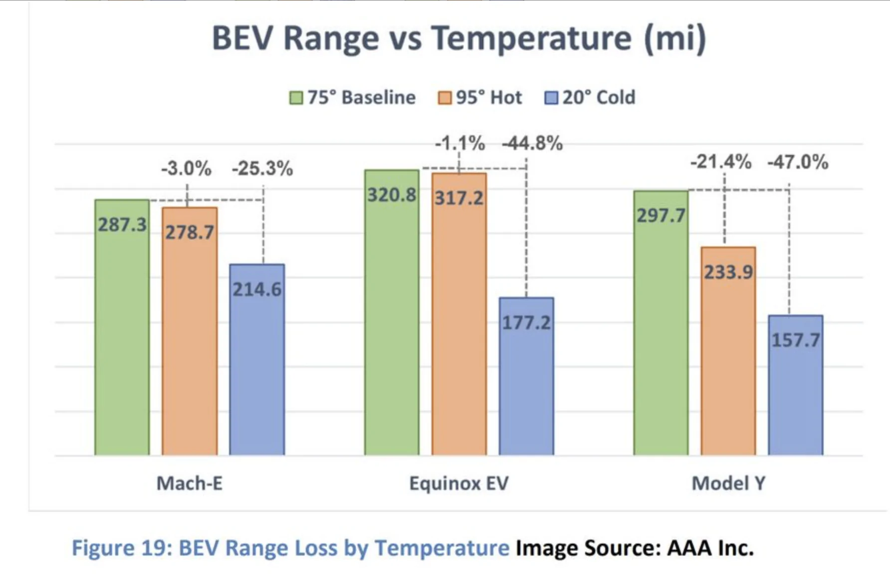

Why does heat effect the Model Y so much?
Great to see though. An almost 50% range loss is quite a drop.
Just speculation, but the Y achieves comparable range to the MME with a smaller battery through greater efficiency. So if your range is more heavily dependent on efficiency, your range will drop more when that efficiency decreases? I dunno - maybe that doesn’t math.

That maths. Same reason EVs are hit so much harder by wind resistance.
All batteries are affected by heat and/or cold.
This just shows how much engineering Ford has put into the HVB's thermal management
Noted that all the vehicles were MY2025, and they all have heat pumps, would have been interesting to see a 2024 MME in the test as well for comparison on the new heat pump...

kind of surprising for an early owner like myself to see, because from the beginning there have been a lot of complaints that our winter range drop was much worse than model Y
i see they used the 2025 mach e which has the heat pump, but the model Y also has a heat pump so i'm confused still at the differential. and what was the pre-2025 mach e decline then for us to think the model Y was better, -75%? something feels wrong
my personal experience with 2021 std range is in the summer i have ~220mi range and in the winter ~180mi (with minimal / no heater usage, only seat warmer + steering wheel)

This: Six models were hooked up to a dynamometer
The indoor "treadmill" verse real world ambient conditions. Those of us who live in real winter conditions note the pre-2025 heat pump equipped Mach E will lose battery temperature while driving during cold winter temperatures. This is true even with "pre-conditioning" prior to departure. As that battery temperature drops so does the m/kWh efficiency. The indoor treadmill does not provide the cold winter wind flowing over the top/bottom and sides of the Mach E battery pack inducing conductive thermal losses that owners note and wish they could minimize.
Study is also flawed in that the three EV's were not identical in drivetrain configuration.
Can not explain the Model Y results. Article failed to speculate or discuss such.

i don't see how the lack of windchill matters here, it is the equivalent of saying the results of 20F might only mimic a real-world temperature of 25F (where windchills are bringing it to 20F), but that's not the point since the goal was to compare different cars and not test specific temperatures

Real world testing could reveal the Mach E loses 12f more battery temperature than a competitor.

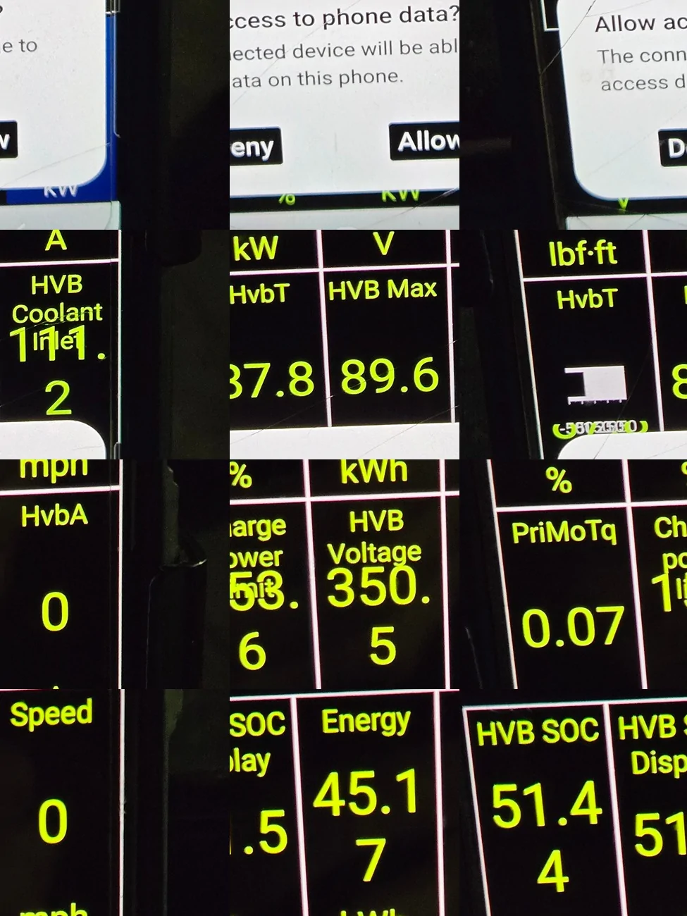

Ford Mustang Mach-E AAA test: Mach-E maintains range best vs other EVs, in tolerating hot & cold temperature swings. :) 1000008851
This reveals a deals a significant drop in battery tperature during winter weather.

or it could reveal that the '21-'24 loses more than a '25-'26
perhaps due to the heat pump, the new rear motor, or both...
Until the different years are tested side by side (and all drive configurations as well), we may never know...
