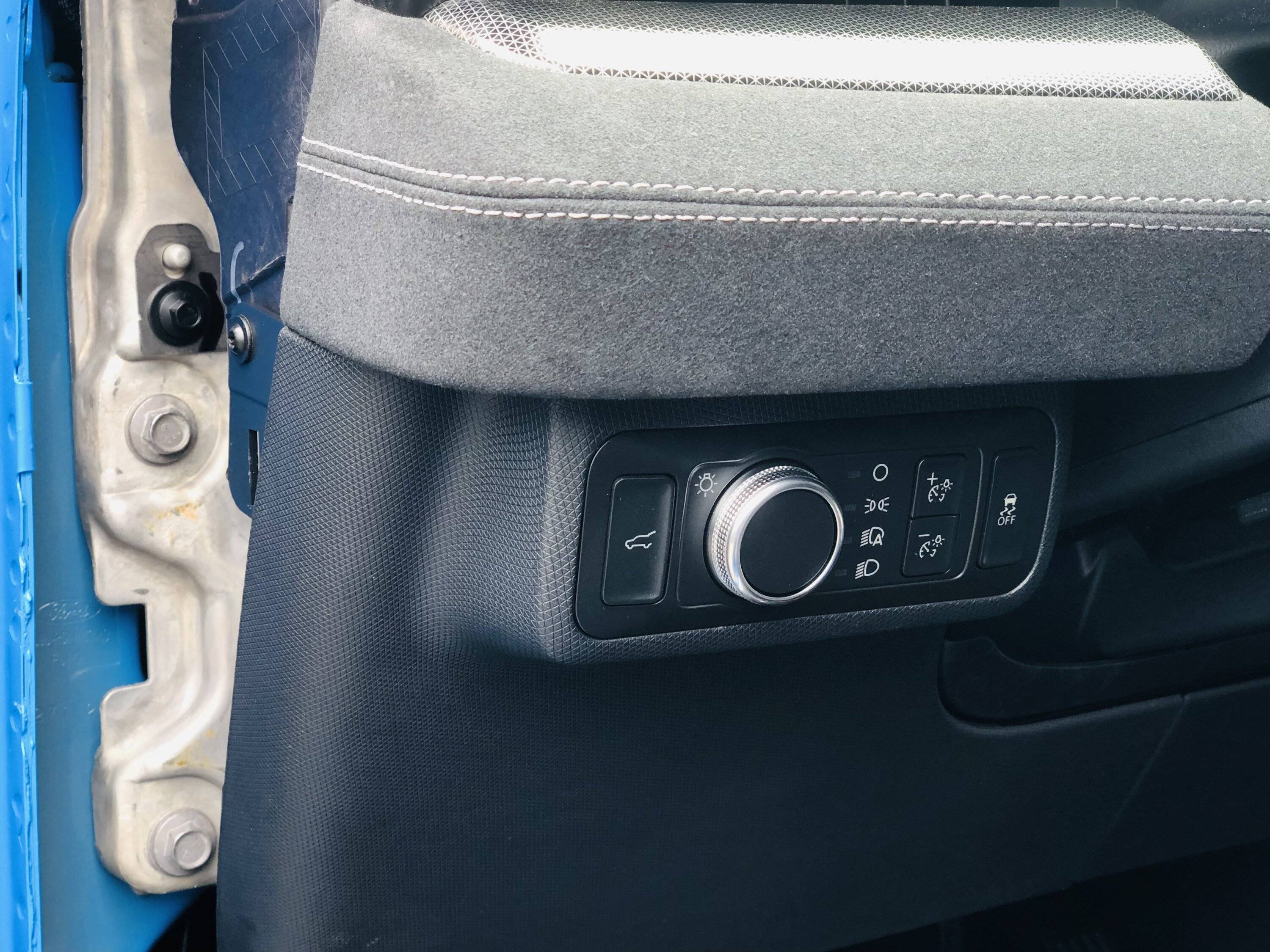

Found a bit of time today to get this done. I can confirm that Ford Explorer part # LB5T13D061NB does work perfectly fine.
Going to add in the pix i took incase it helps anyone else out. I had some issues figuring out how to run the cable at first until i took off mutiple panels.
Thanks markboris and i8iridium for figuring all this out =)
Thanks to you, @markboris, and @i8iridium I was able to do this too. I purchased the light cluster with Liftgate button on eBay (I presume it was from a wreck), and followed your and Mark's very helpful posts. On the driver side, I ran my wire under the dash in a rubber cable channel at the junction between the under dash trim piece and the footwell. So the wire didn't need to go under the carpet. I wrapped with electrical tape anywhere that I thought might wear, as well as taped the wire in areas that I thought might either wear or rattle. And like you, I just stuck the wire into the back of the connector, though I did bend the wire into a zig-zag in order to create higher pressure contact points with the pin of the connector, and then taped the wire to the rest of the harness. Hopefully that will work for the long term, though if you find the right pin size, I'd love to know!
I don't know how anyone could do this job in an hour! Took me about three, but then I'm not typically doing this sort of work and I had to do it on a level(ish) cross street since working in my garage/driveway/street is infeasible!
Nonetheless, I'm pleased with the results. It looks like the button has always been there (as it should have been). :)

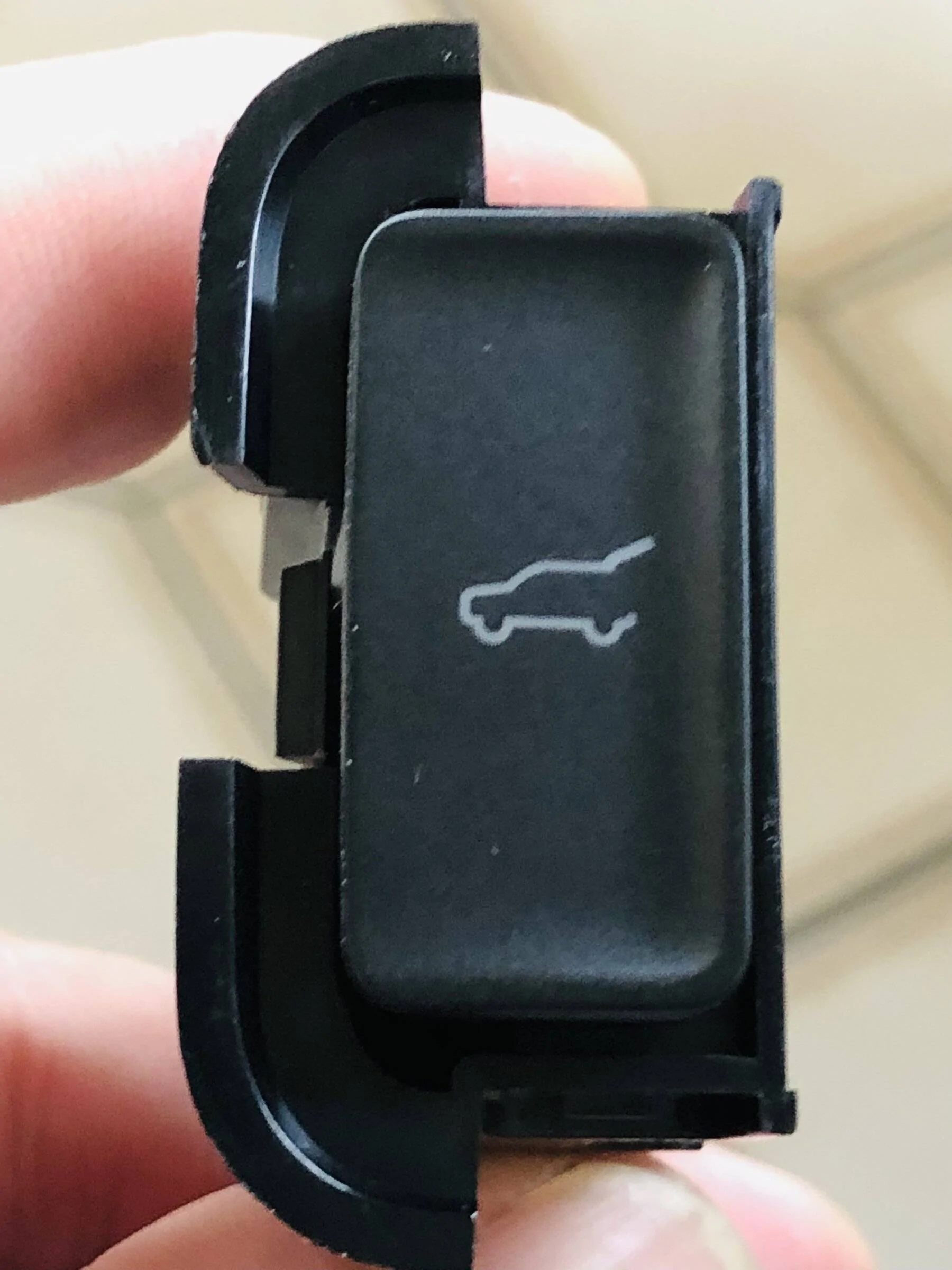

Look what came in today! ??
Ford Mustang Mach-E Adding a Physical Interior Liftgate Power Switch 7BE0B99C-EA80-4667-96E6-A591A39B35FC
Now I just need to get some female wire terminations and some wire. ??

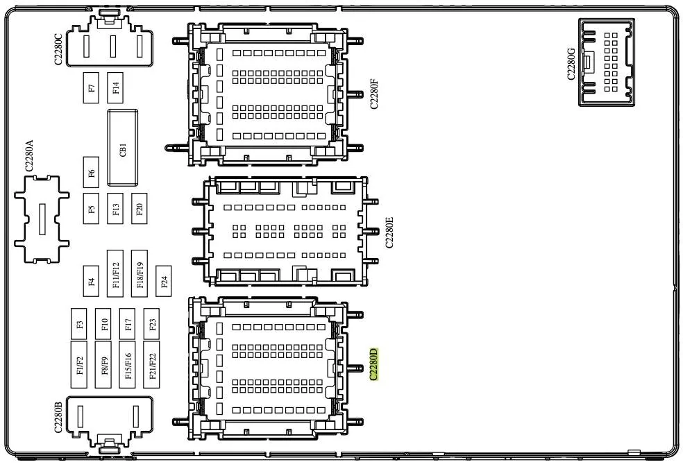

Alright Eric, if you want a second horn button, here is how to do it:
You need to tap into a Green/White wire at C2280D connector in the BCM (Body Control Module).
The BCM is located behind a panel where the front passengers feet are. To remove that panel, you first have to remove the under dash panel which has two clips. Pull it down and out then grab the plastic panel over the BCM and pull it straight out. The C2280D connector is the large one on the bottom. Carefully remove about 2" of the black cloth wrap that is around the wires and find the Green/White wire (Green with very very thin White stripe).
Here is the tricky part, there are TWO of those colored wires in this connector. The one you want is slightly thinner than the other. Attach a wire to the Green/White wire (however you want to do that) and short it to ground. The horn should work as soon as you do this. If it doesn't, you have the wrong wire so connect it to the other one. You won't mess up anything if you short the wrong wire to ground. Then of course all you need to do is install a momentary switch wherever you want, and run the wire from the Green/White wire to one side of the switch and a ground wire to the other side.
I have verified this works (like I do all mods I post) so have at it and let us know how it turns out.
I have orientated the photo below how the BCM looks when you remove the panel. Again, it is the bottom connector C2280D.
Ford Mustang Mach-E Adding a Physical Interior Liftgate Power Switch Screen Shot 2022-05-31 at 3.00.13 PM

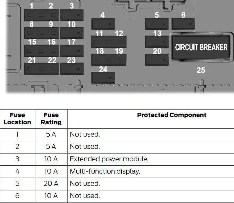

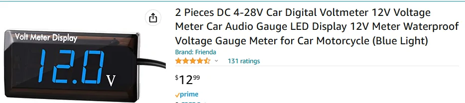

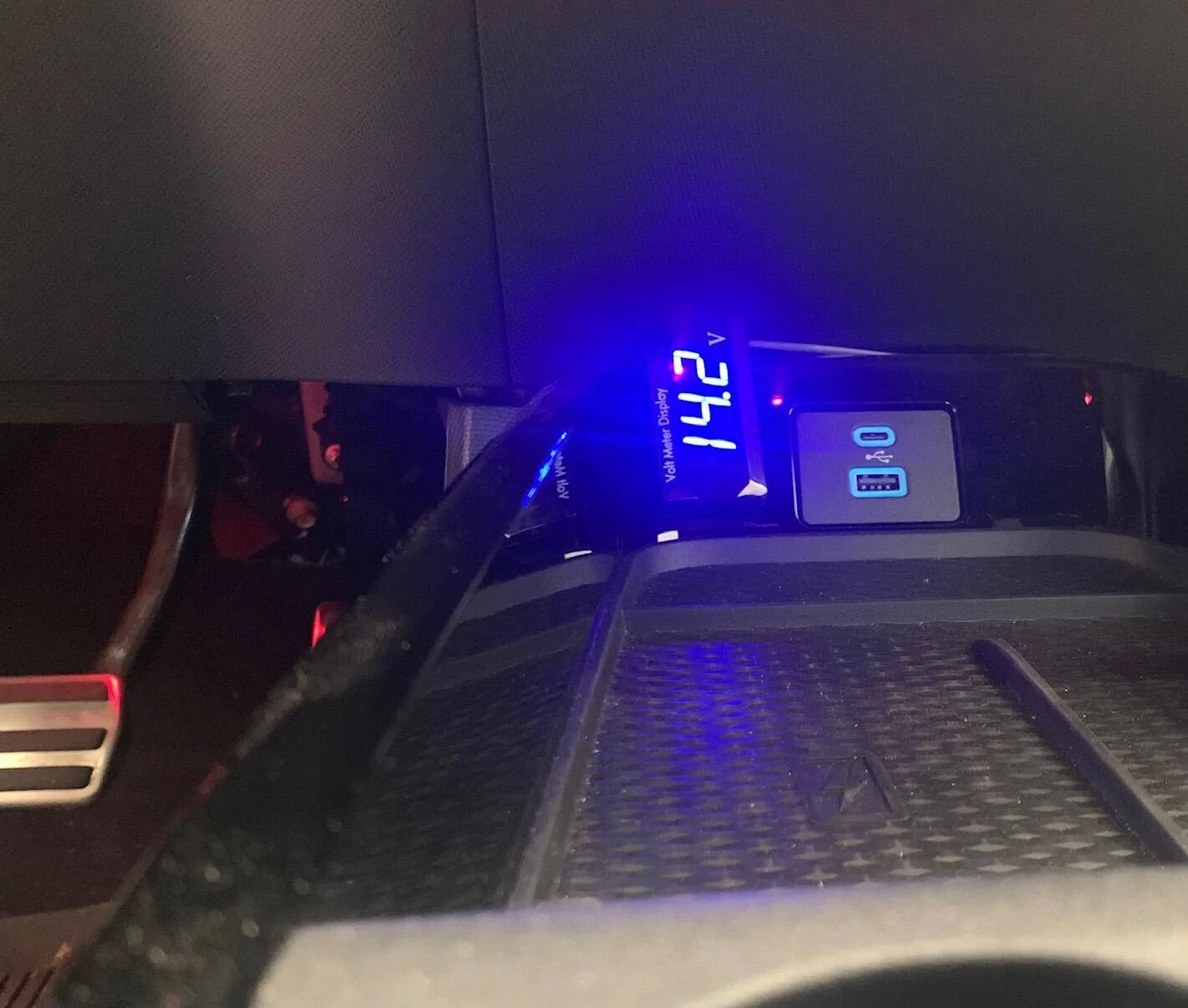

About 2 months ago I mounted voltmeter next to the USB-C plug just to be able to monitor the Low V Battery condition. Works great, but I couldn't find the space to mount horizontal & was too cheep to buy a smaller display. Tied into either fuse 5 or 6 in the BCM (can't remember), but it was one of the only circuts that shut off with car. Normally charged it reads 12.4 to 12.8. With Accy draw (headlghts, fan, A/C, etc), goes up to 14.2 to 14.4, as it charges back up steps to 13.3 then 12.8 ish. the display doesnt dim so mounting it low keeps it from being a distraction.
Ford Mustang Mach-E Adding a Physical Interior Liftgate Power Switch 1654977564486
Ford Mustang Mach-E Adding a Physical Interior Liftgate Power Switch 1654977609517
Ford Mustang Mach-E Adding a Physical Interior Liftgate Power Switch 1654977659462

OK, procrastination over with:
Ford Mustang Mach-E Adding a Physical Interior Liftgate Power Switch C3018AB7-90C3-48E6-803C-99AEB5C9C9E0
Ford Mustang Mach-E Adding a Physical Interior Liftgate Power Switch 47C33FDF-2089-466B-AD1D-F8F0531E1F70

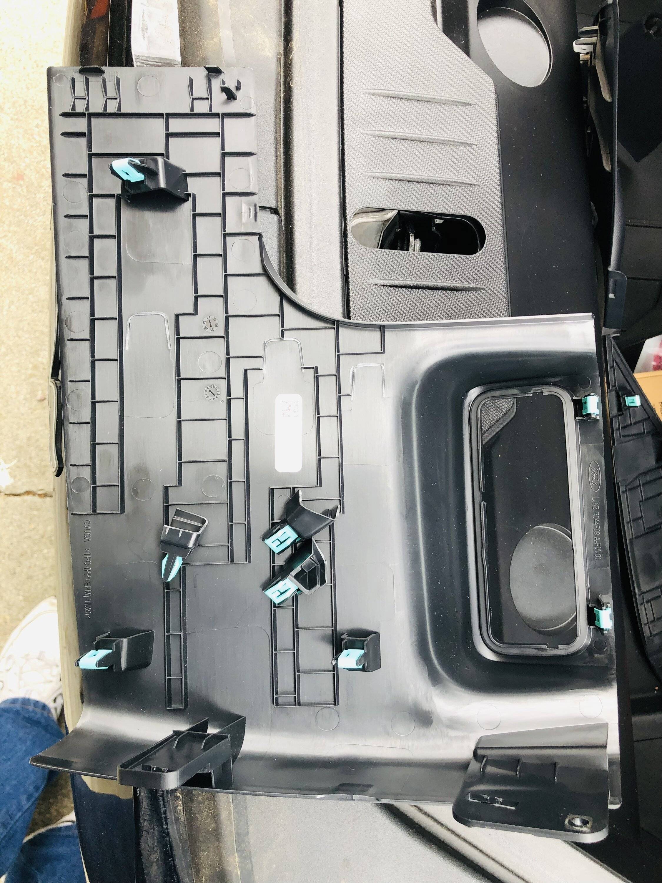

I busted three of the retaining posts for the driver’s side panel, so don’t be like me:
Ford Mustang Mach-E Adding a Physical Interior Liftgate Power Switch 944C92F7-2E62-428A-9AD7-2A5ED5587F53
I bought a big roll of brown wire and used like 6 or so feet of it. ?? I had to use the same color as went into the BCM. ??
