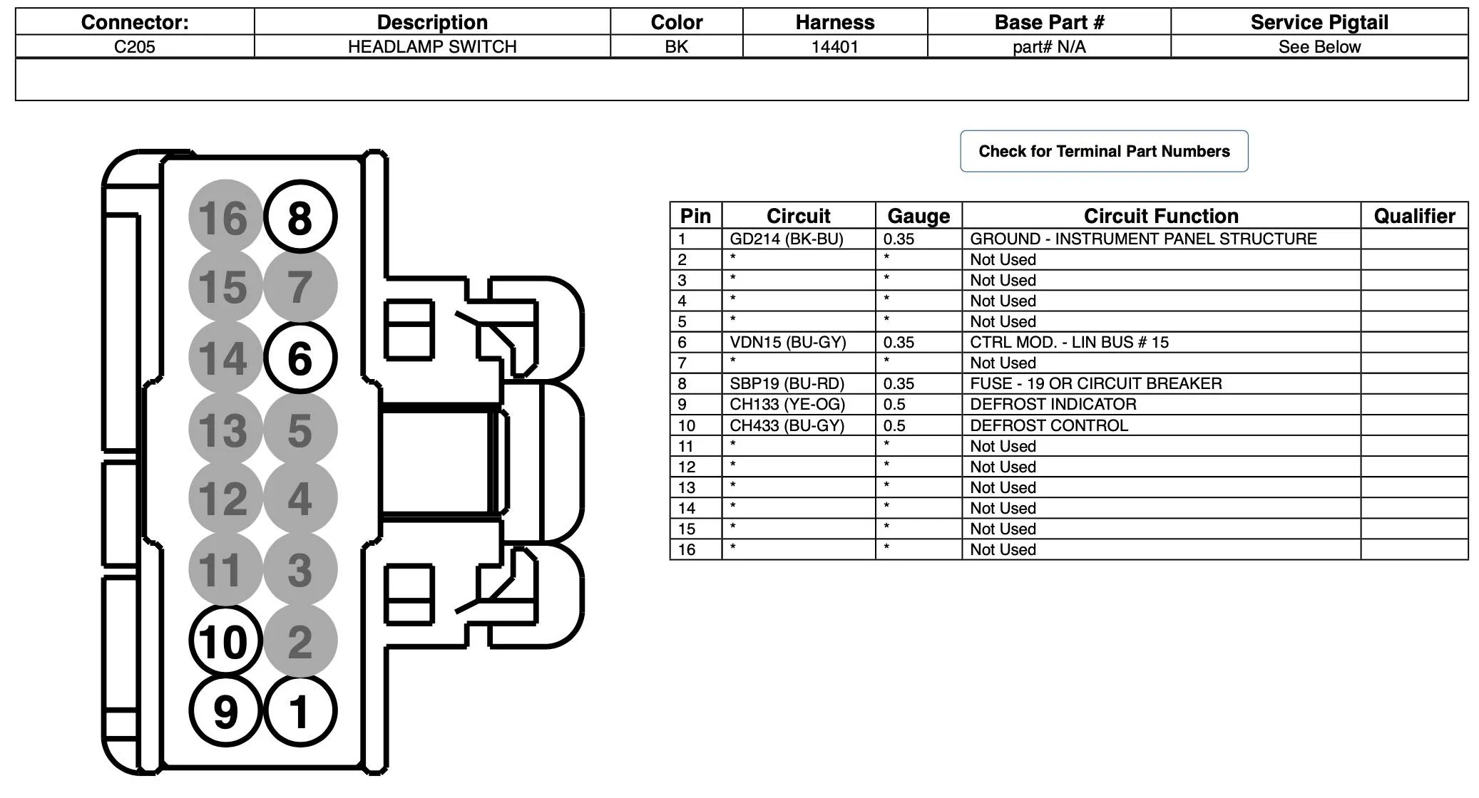

I'm in Colorado for the weekend but if I was home I would show both switches apart and post some better photos but it is really simple to do. In case you missed it, here are the repair manual photos how to take out the headlamp switch. #61

I'm not sure exactly what is being asked here and am kind of confused with what krazieboy is trying to do. In any case I did the same as what Pat (i8iridium) did and purchased the Bronco headlamp switch (M1PZ-11654-AA) removed the liftgate button from that switch, and replaced the Max Defrost switch in my GTPE headlamp switch with that one. Ran a wire from position 12 on the connector to the BCM. #57

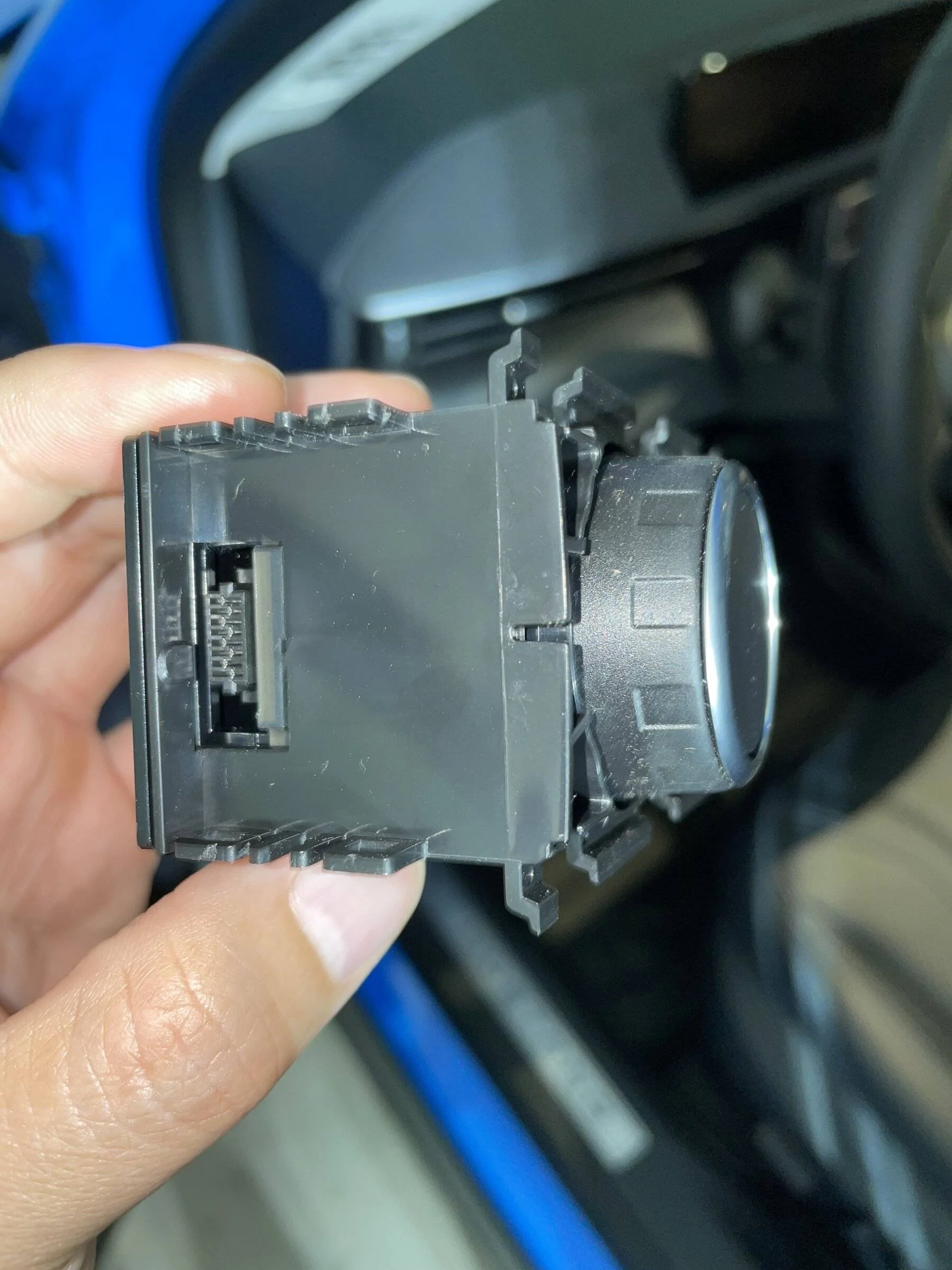

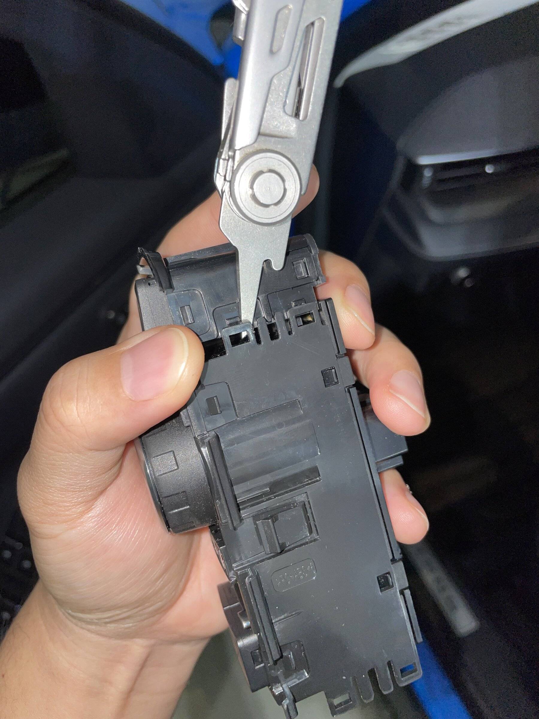

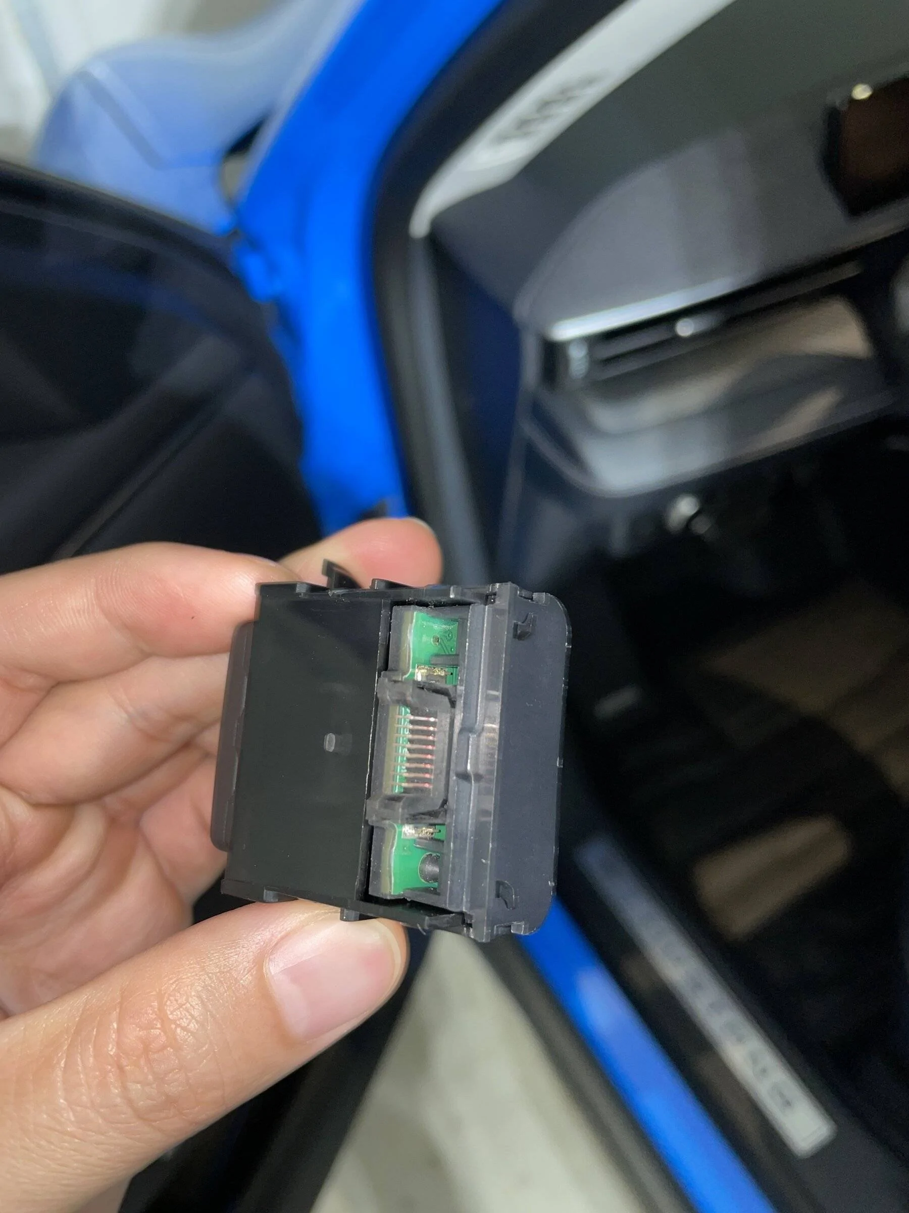

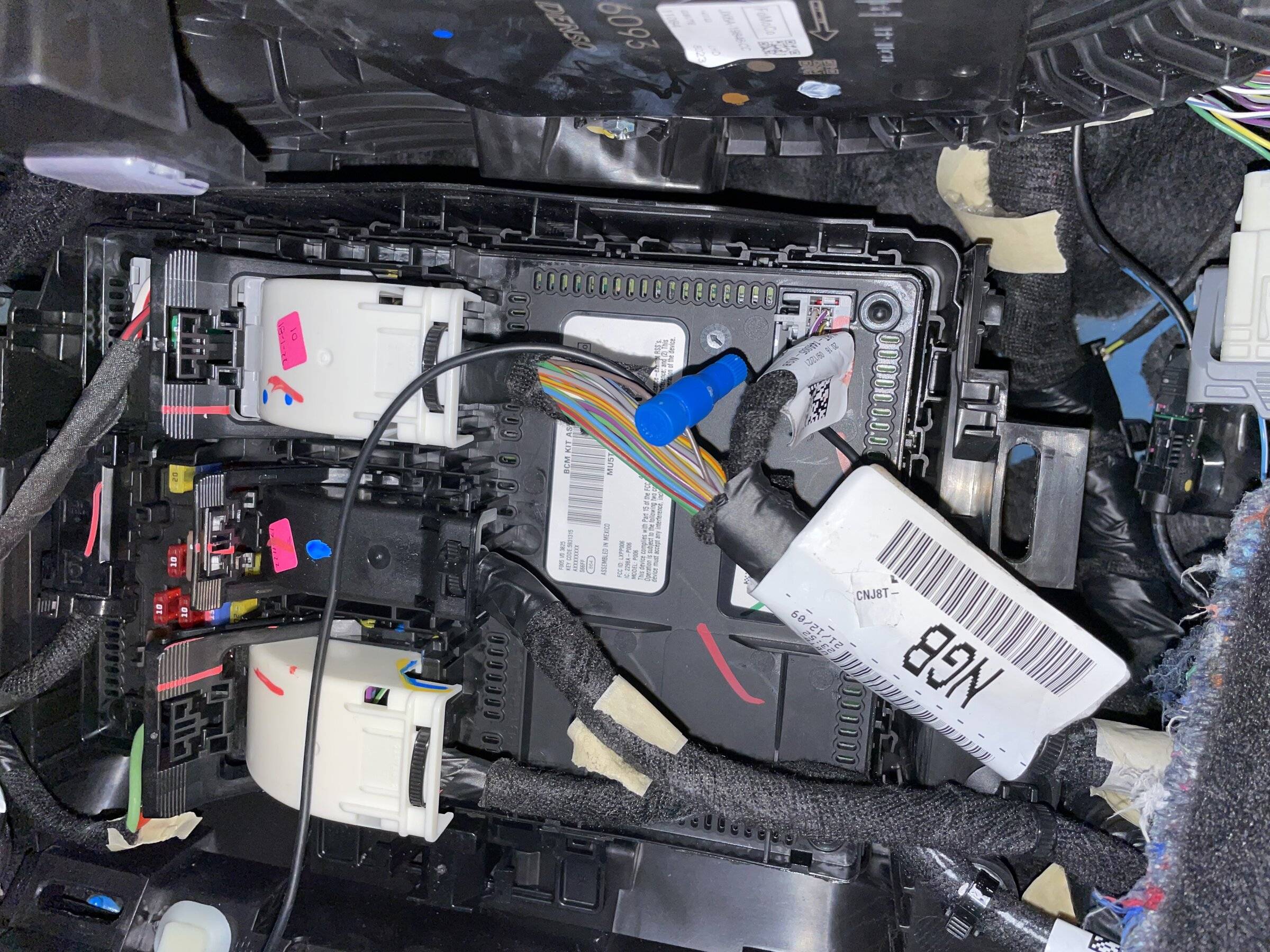

I finally did this mod a few days ago in my premium after having talked about it with @markboris for a couple of weeks. Here was my process.
I ended up buying the bronco headlamp switch and swapped that out with the max defrost. I live in Southern California so I have absolutely no use for it as I park inside and screen access is simple. I started by tapping the brown wire and then running that through the panels just to the left of the BCM picking up the wire from the panel to the right of the acceleration pedals. I ran that behind the pedals up and up through the frunk release.
The most time consuming stuff was just removing the panels carefully to not snap any of the clips. When I got all of them removed it was easy to unclip the wire harness and pull out the headlamp switch. Switching out the button was easy, after you take off the faceplate, I just put tension like I was popping off a bottle top and pried up the clips on two sides, when the two were free, the button popped right off. Replacing is just as simple.
I'm not that technical so I decided not to go through the trouble to install a pin into slot 12 I just stripped a little excess and shoved the wire in there and taped it down to the harness. You don't have to remove anything from the harness because pin 12 is completely empty and unused. I had some issues testing it before I put everything back, ended up finding out that the tap at the BCM wasn't sitting right so I adjusted that a bit and it worked fine. The wire at the headlamp was never a problem.
Very satisfying project for me, overall very easy, the most difficult part is the panel.
