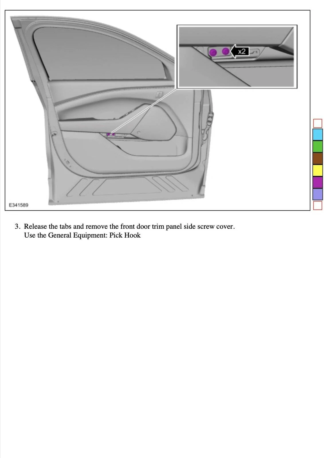

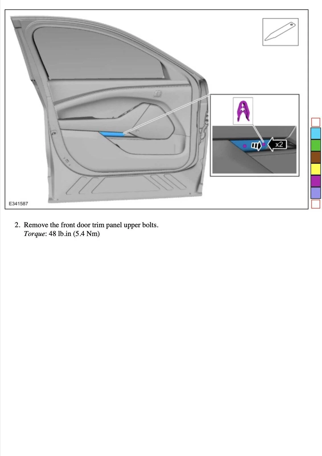

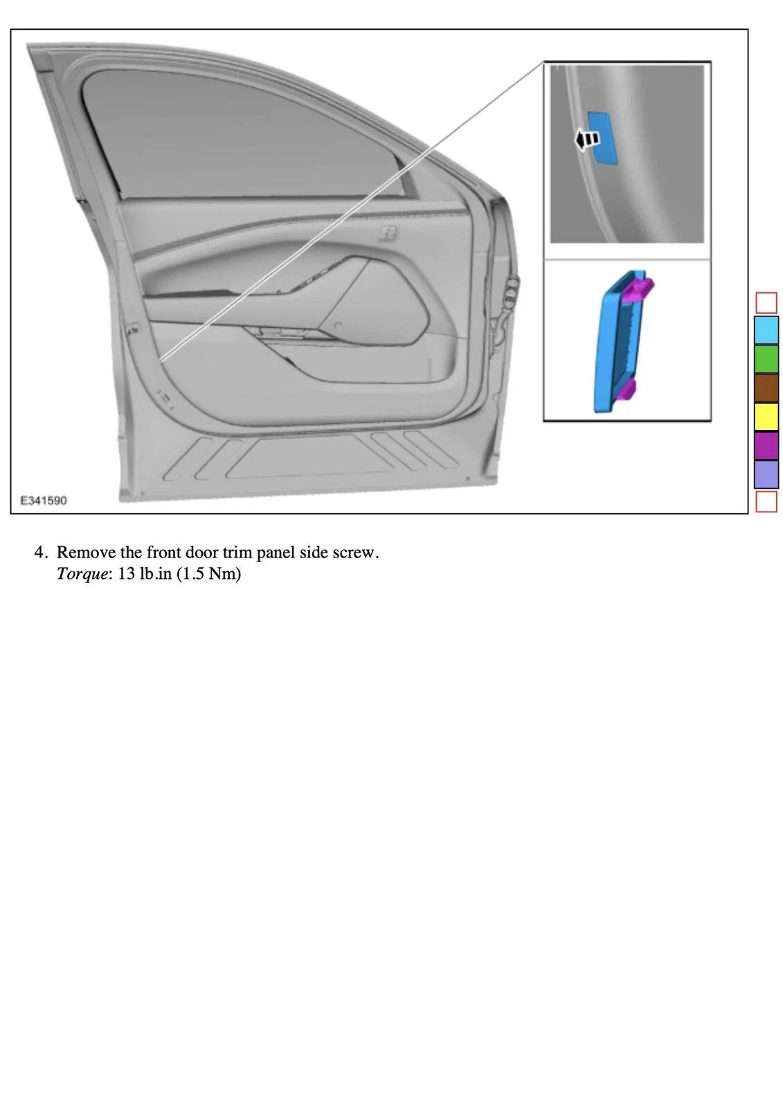

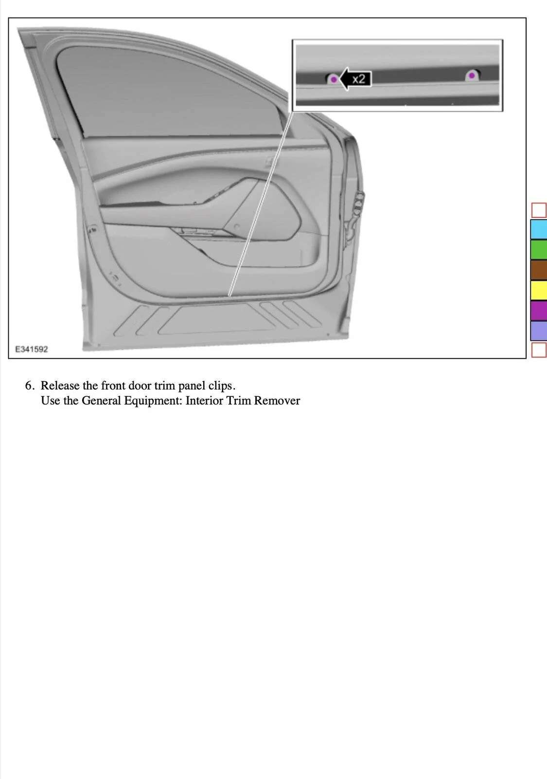

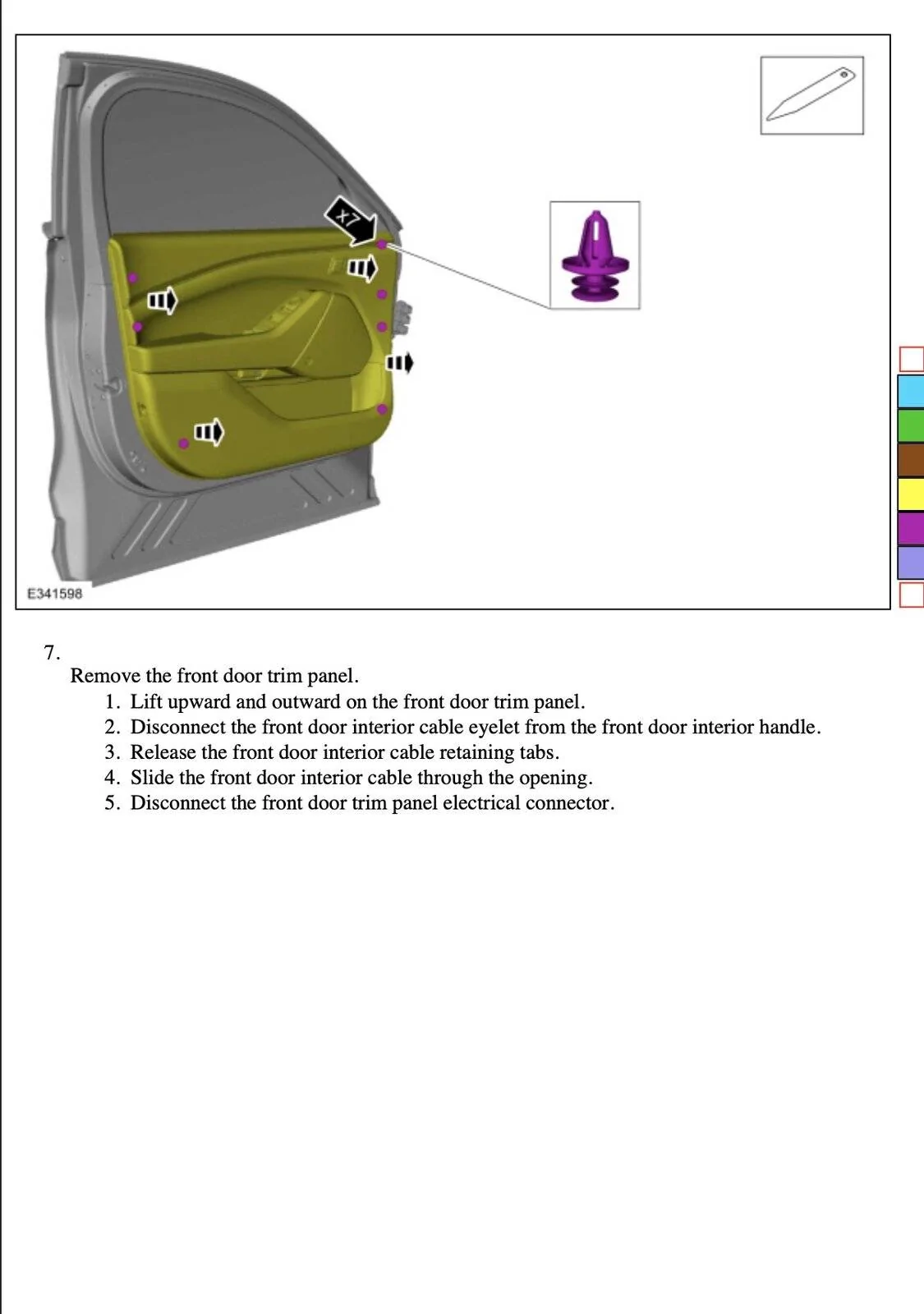

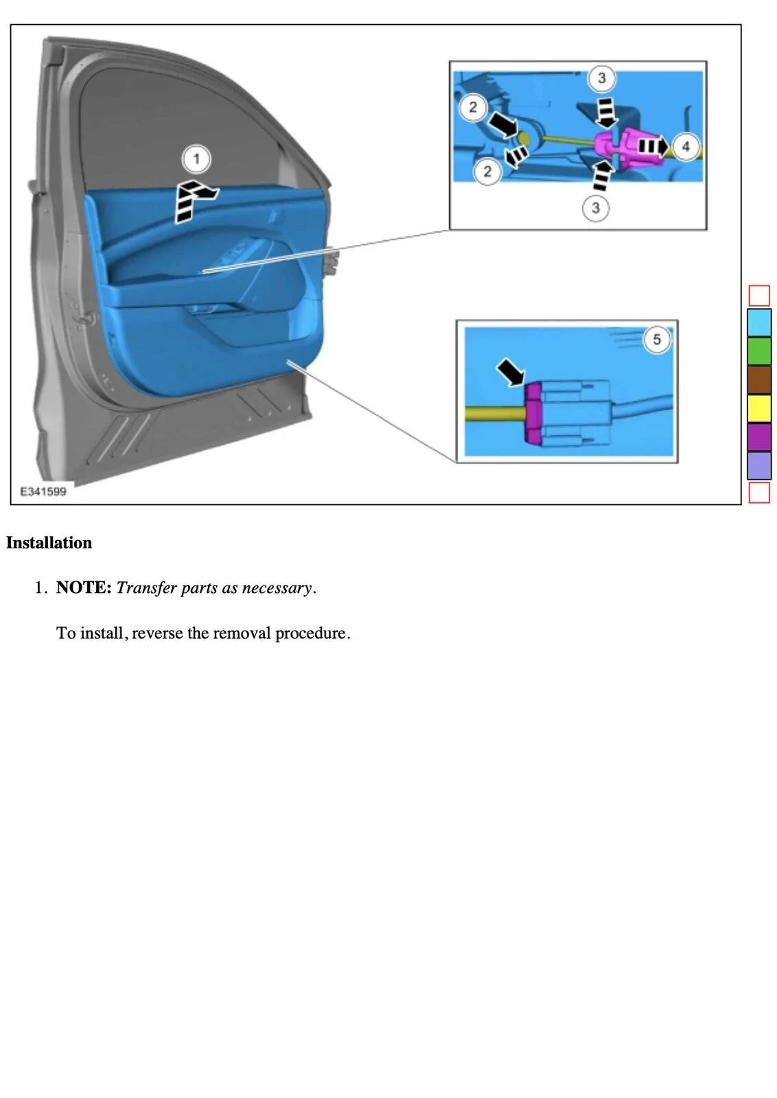

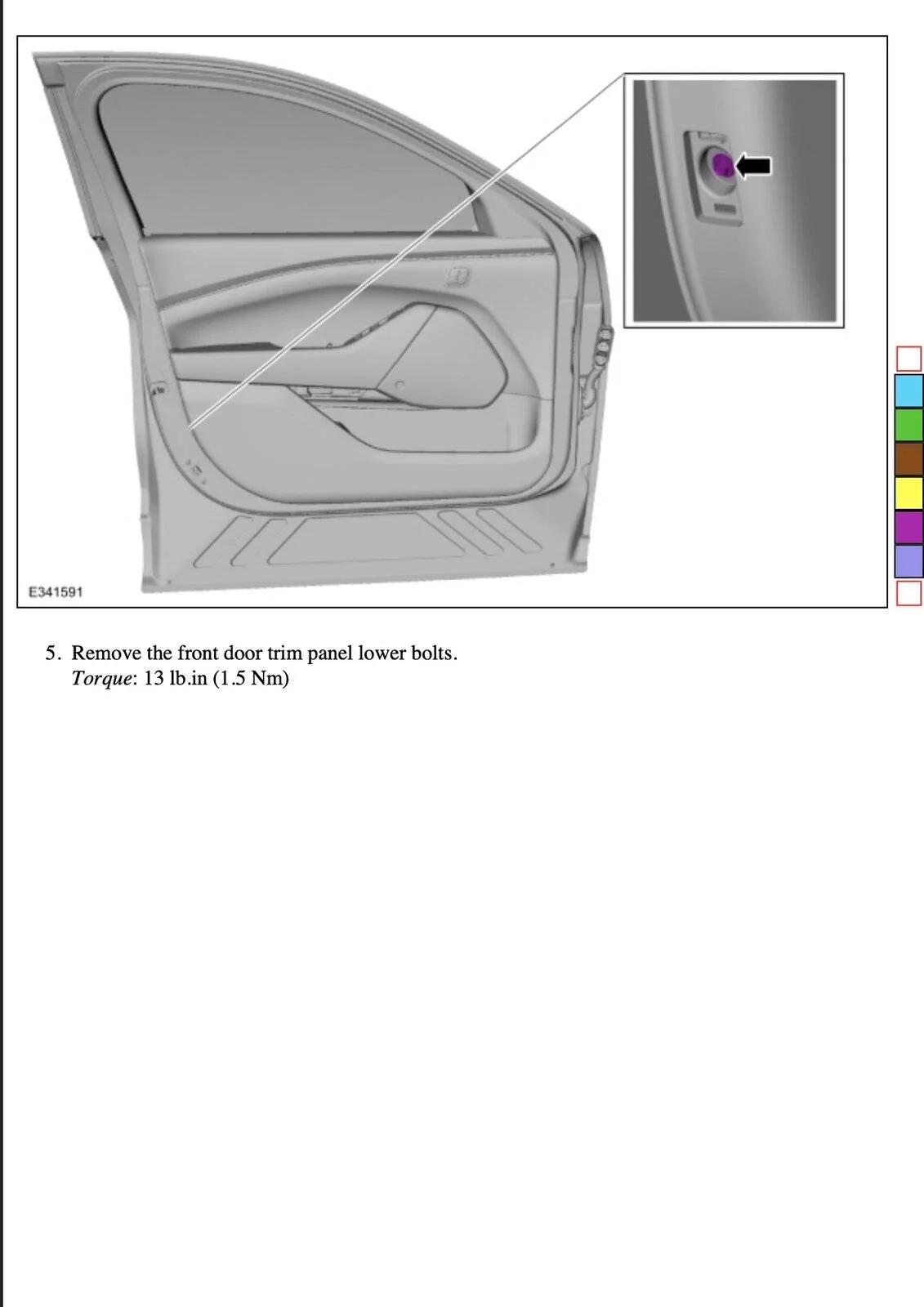

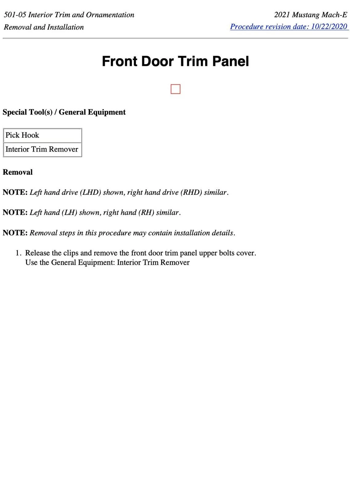

Hi Martin, you do have to take the door panel off. The speaker grill is attached to the door panel from the back side so it will not come off from the front. Even if it did come off, the mounting screws to the speaker would not be accessible as the grill is not directly in front of the speaker and slightly angled. It's really not difficult to remove the door panel but then I remove a lot of door panels. The clips that hold on the panel are very tight so you really have to pull on the panel to remove it.
Below is are photos from the service manual on how to remove the driver's door panel. The passenger and rear door panels are similar.

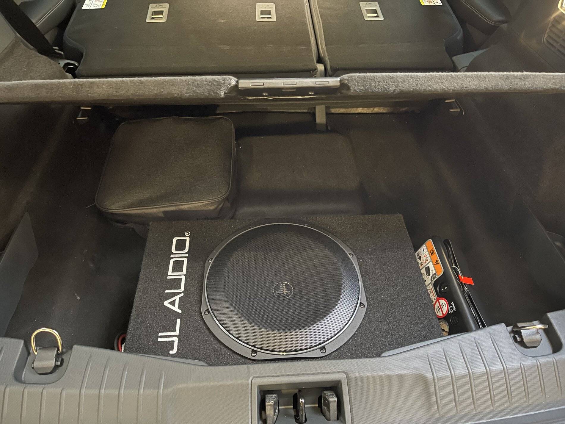

@markboris
DId you remove the two studs on the bottom of the well? and the 12" is not fitting in to the sunken area for me....
markboris
markboris
Nov 13, 2019
43
5,732
16,371
Sonora, CA
@markboris
Yes i removed the two studs that are in the floor otherwise that 12" JL sub would not fit.
