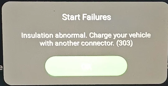

I tried multiple chargers yesterday. It failed once on the Autel charger with the error message "Insulation abnormal" I tried the other connector and it worked. I also tried an EA charger. It was charging for 10+ minutes and saw the charging stop and on the car, I saw charger unplugged message. I think previously on the road trip I think the second lock did not engage. I heard the lock engaging after the charger was connected to the port after the first clip-on sound. I also think the charger is getting disconnected due to the wait or lock not holding it together.
Will try multiple charge sessions again.
Thanks, everyone.
