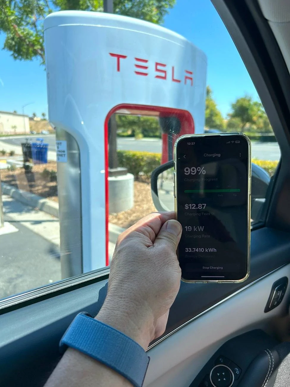

Road trips I charge to 100% on DCFC using Tesla Superchargers - no one waiting with lots of open chargers so why not - never know if there's a detour along the way or delays on a long drive.
Locally at home/work I charge to 90% on Tesla Superchargers.
In my garage, I charge to 100% on L2.
Not worried about battery degradation - will be trading her in at the 3 year warranty expiration mark.
Ford Mustang Mach-E Charging to 100% and using DC fast charging frequently IMG_2452
