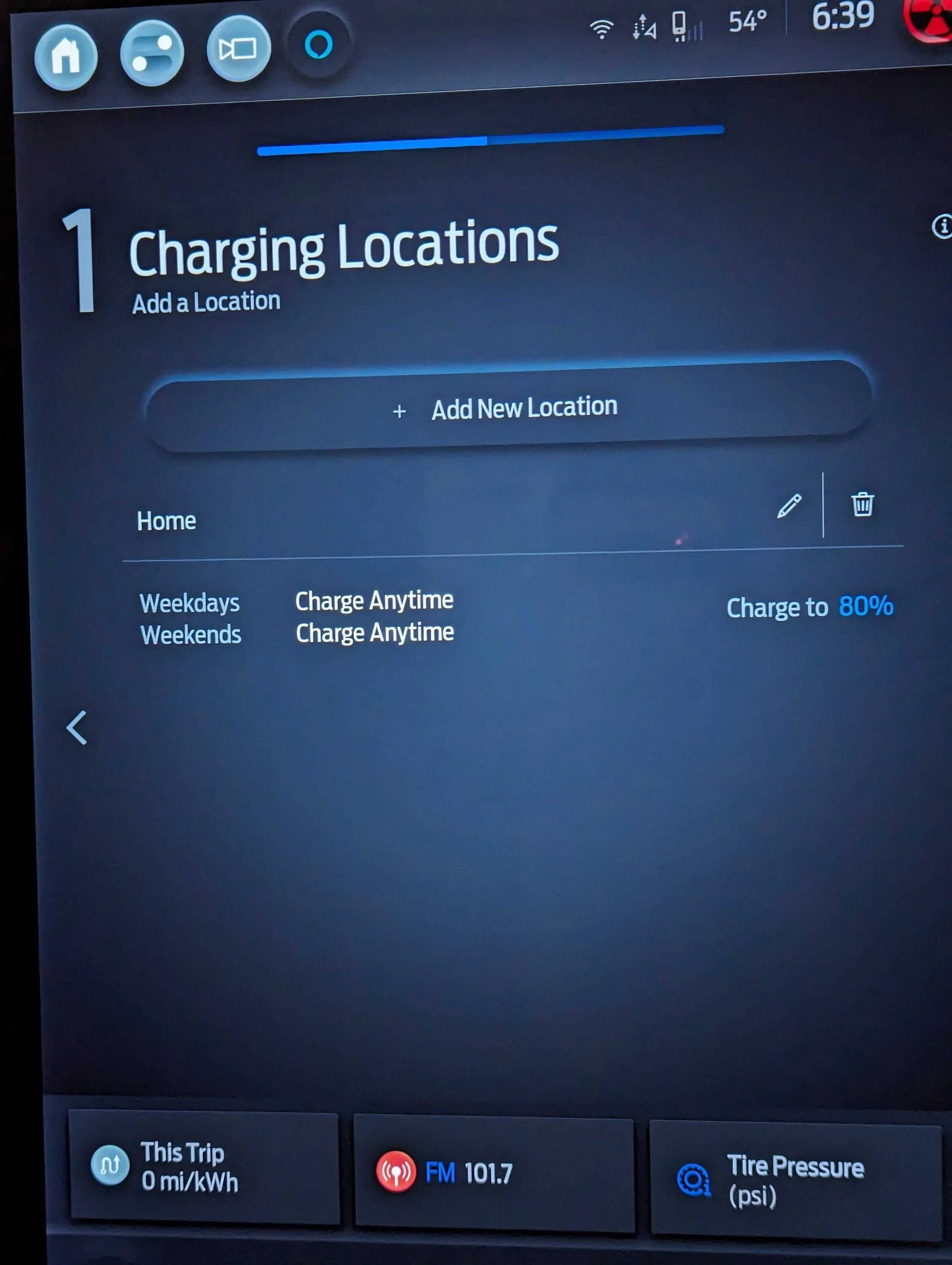

AtomicInternet
Jul 31, 2023
1,009
1,577
SC
Focus RS, Mach E Rally
It's actually in the charging app. Make sure "preferred charge times" is turned on and then click the pencil next to it to change the settings.
