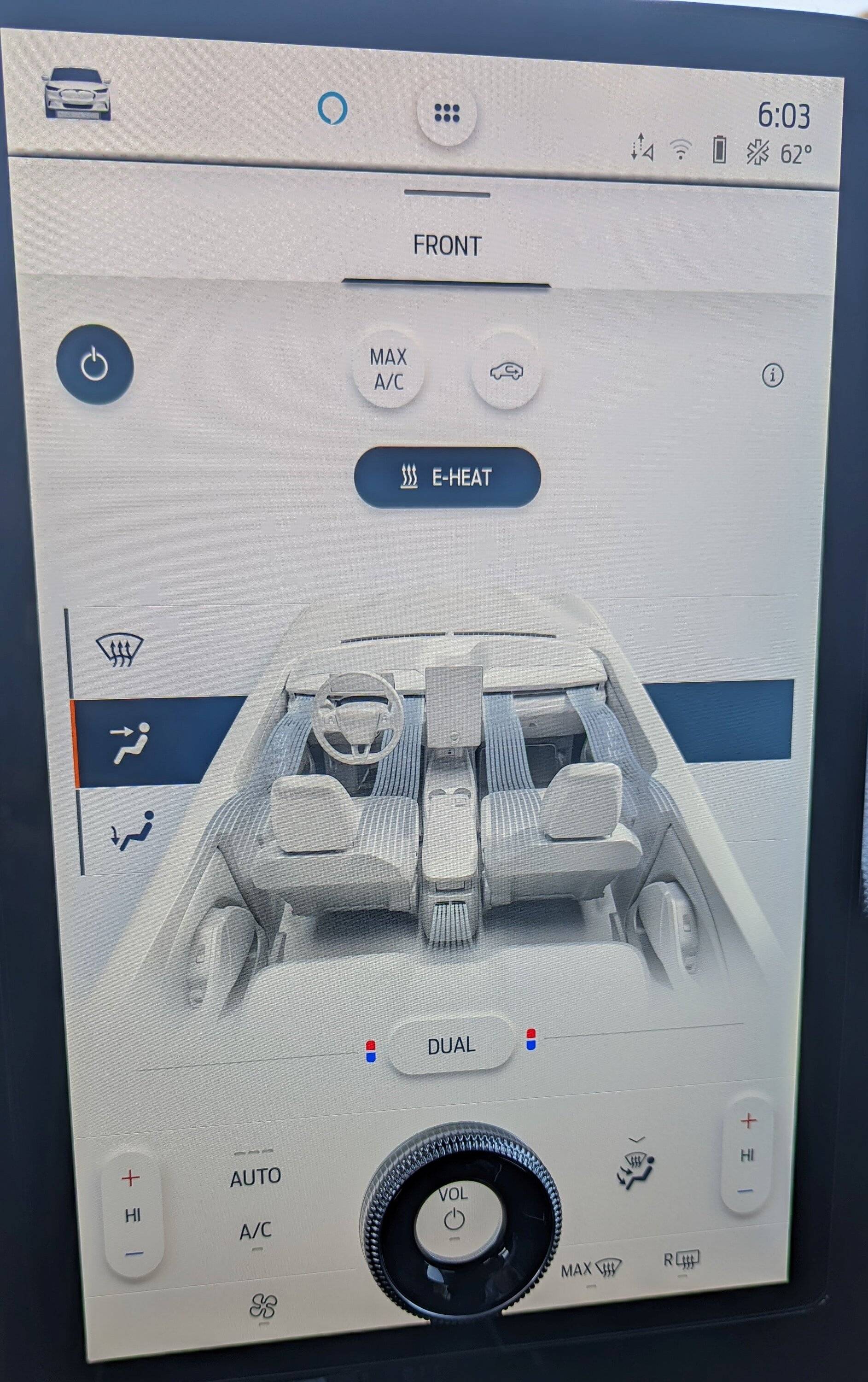

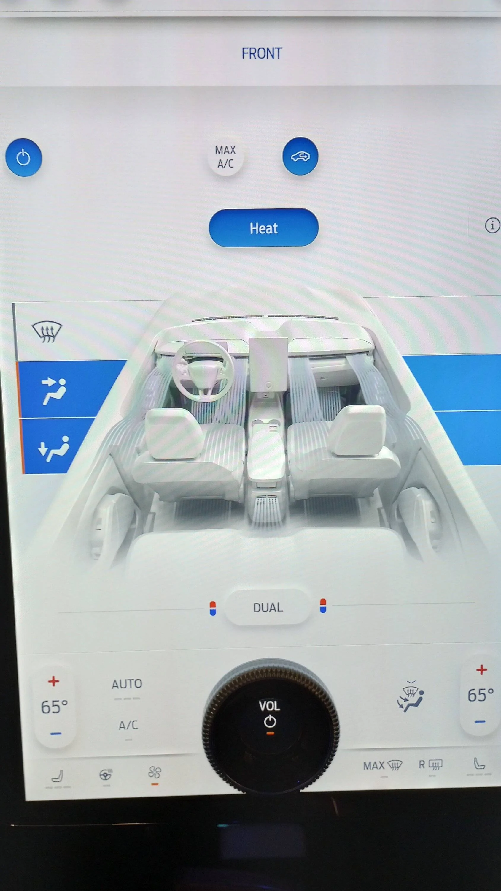

@MacherAWD @JRT @Mach-Lee @LUV_RED so I tried the auto last night
This is here auto with AC off, I also tried this same setting with AC on
Ford Mustang Mach-E Am I asking for too much ? PXL_20230412_010241470
This is here just high, no auto no AC
Ford Mustang Mach-E Am I asking for too much ? PXL_20230412_010325086
car was moving when I did the test, both on the highway and at stopping, was still getting cold air, I guess my conclusion here is my AC module needs an update, another reason to why I think @Ford Motor Company must push those modules update all the times, imagine trying to get this fixed after the warranty expires!!! paying $$$$$ for a software glitch!
