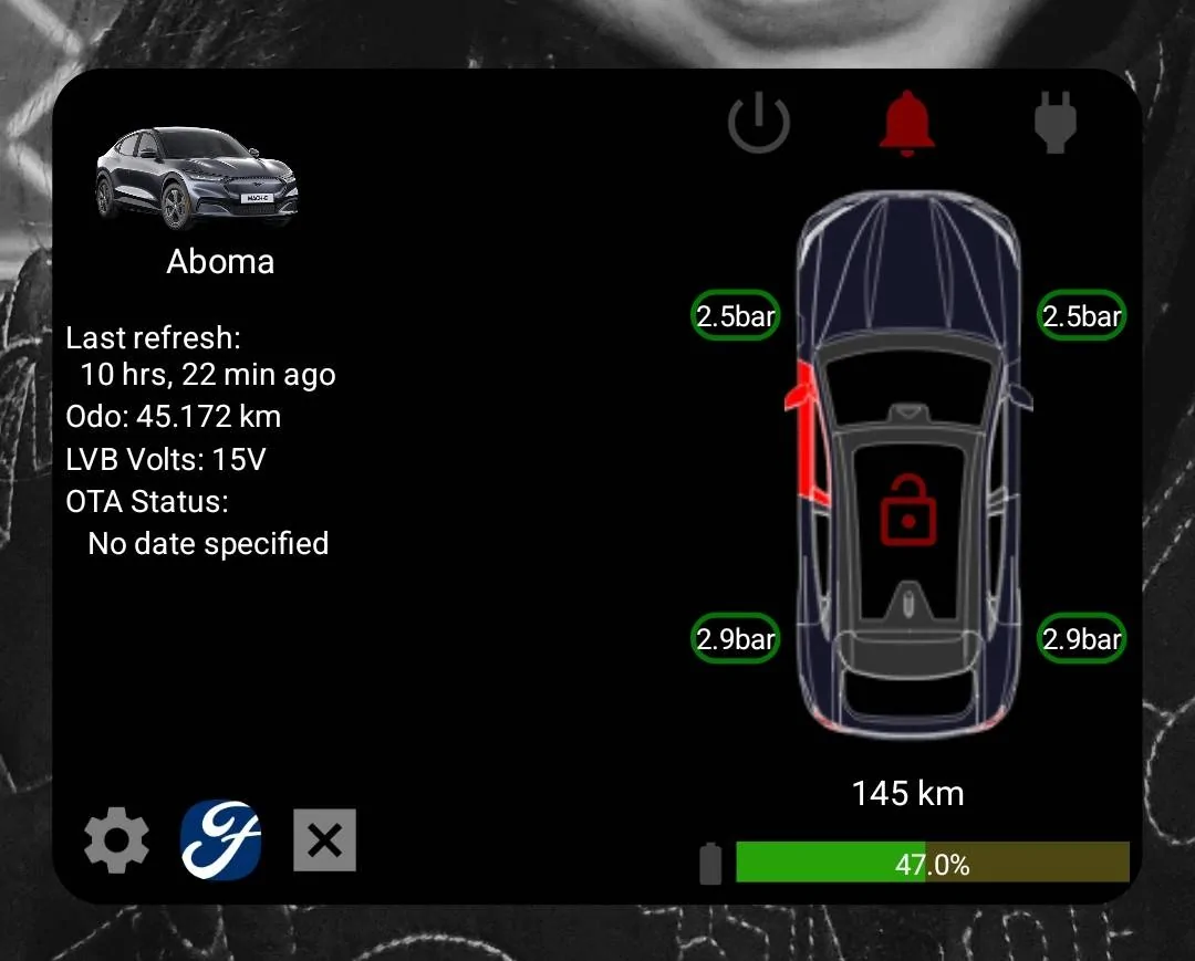

Hi, I have been using the widget for some time now. I have a rwd Sr MME build somewhere in April 2021. Just recently my dealer did some updates. After that I was able to connect to my wifi and actually exchange data. So my guess was that OTA would also start. However no sign so far. The only thing I found I that sometimes mostly during the night my door gets red in the app. While I'm sure the door is closed. Does anyone have an idea what this means, and what this might cause?

This happens to me too. I think the MME sends its status when is active, i.e. opened, then it goes in sleep mode and periodically refreshes its status. If you look at the last refresh time it is just before locking it, when the door was open. I noticed that when I open FordPass it seems that it forces MME status update.
Ps not very confident my dealer knows....
Don't rely on the widget for OTA info anymore. Ford (unfortunately) changed its API in September and there's no known replacement for it yet.
