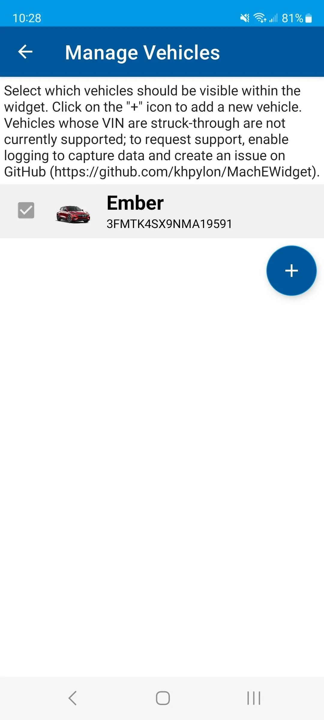

From what I'm seeing in the log, it looks like the app doesn't see any vehicles assigned. If you go to "Manage Vehicles", is it showing your car?
Ford Mustang Mach-E Android Widget for Mach-E [Less Complex] Screenshot_20230223_102836_Ford Status Widget

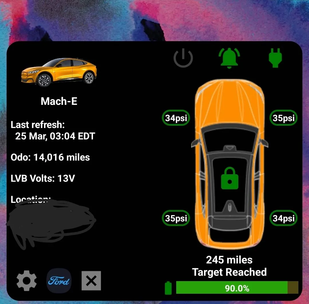

I just wanted to say the current iteration of this widget is just brilliant. I love having this as an option over always having to open the janky AF Ford Pass app for basic info. Love that it reflects my car's actual color (unlike the vehicle icons in the car's UI ?).
