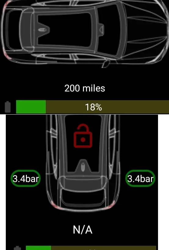

@kennelh: Thanks for your useful widget. I noticed that on my phone the small and medium widgets always show 200 miles range and the big widget shows N/A (see photo).
Could you check if it is an issue of the metric units I use here in EU or if it could depend on my Android phone? FordPass shows the correct data. Thanks

Yep... that's a bug for everyone. I just pushed 2023.04.07 with a fix.
