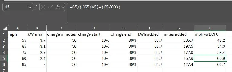

yeah, i still feel that there is no way that it can be faster having to charge extra, or even EQUAL to just driving reasonably. What kind of spreadsheet voodoo you working? I would love to be proven wrong so I can drive fast....lol
Ford Mustang Mach-E Are other EVs this bad? 1741364174393-y4
Like I said- very rough. This does not include the charge you leave the house with. That matters more on a short trip, less on a long trip.
Column B is my non-scientific empirical observations I seem to remember. You should plug in your own numbers if you have them.
I have a 2024 GT and Ford advertises 10-80% charge in 36 minutes.
Convert that to kWh. Multiply by column B to get miles added.
Divide miles added by mph, add charge minutes to get hours.
This would be from the time you plug in at 10%, charge to 80%, then drive to 10% again. Of course there is time spent getting to the charge station, you'll not find a station at exactly 10% charge left, etc, etc.
I decided total mph are close enough that it doesn't matter. Drive the car and have fun.

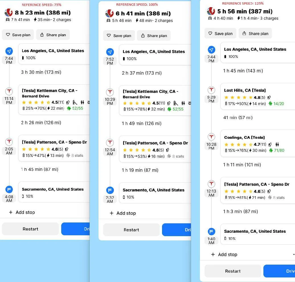

I, for the life of me , can't see how that would be possible in any scenario. Even with optimal charging speed. Can someone do the math here for me?
I apologize for being a fart in the wind! :cwl:
I haven't done testing, but if I make a trip in ABRP with a reference speed of 100% and then change it to 125% (with a max speed of something high, like 90 or 100 mph) you'll see the trip with the faster speed results in a quicker arrival time.
Here are three examples. All are LA to Sacramento, using a 2022+ Mach E GT. Only change I made was the reference speed (max speed set at 125 mph so it isn't limiting). Notice the change from a reference speed of 75% to 125%; the charging time almost doubles but the trip time is estimated to be 2 hours 27 minutes faster.
My take away is that a charger can replenish the battery faster than it can be discharged when driving at consistent highway speeds. (and of course there are always limits and variables I'm not taking into consideration) Will there be a sweet spot for time vs driving speed? Oh yes, and unique to every route and the weather conditions at the time.

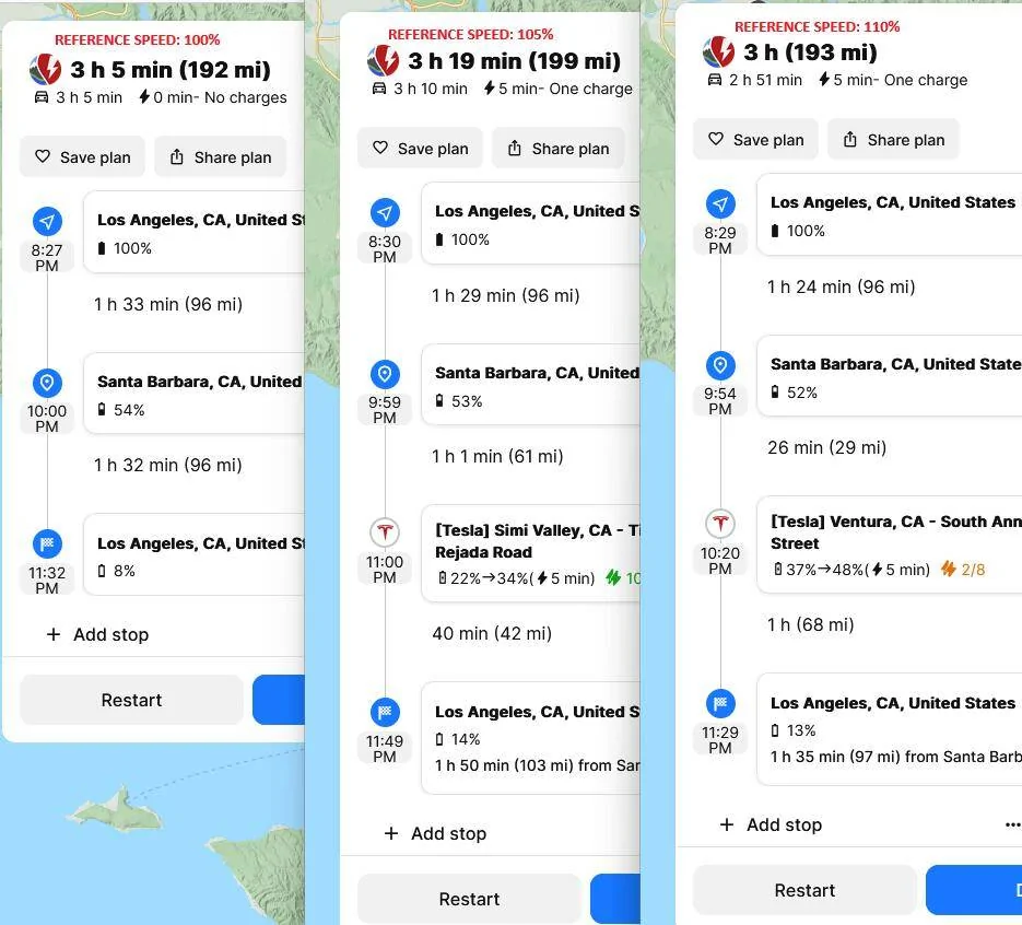

Exactly. Here's another example. LA to Santa Barbara and back. Drive the speed limit: no charging. Drive 5% over the speed limit? Now you have to charge and your travel time is longer. Drive 10% over the speed limit? Have to charge, but the drive time is reduced enough to justify the charge. Avoiding DCFC isn't always the best case for time, but it is usually the best case for cost. (also assuming you don't have to wait for a charger or deal with a broken charger; DCFC can be a crap shoot).
When you get stopped by Police for driving over 90 mph, you'll be booked at the jail around here. You left the extra time for posting bond and getting fingerprinted out of your calculations.
