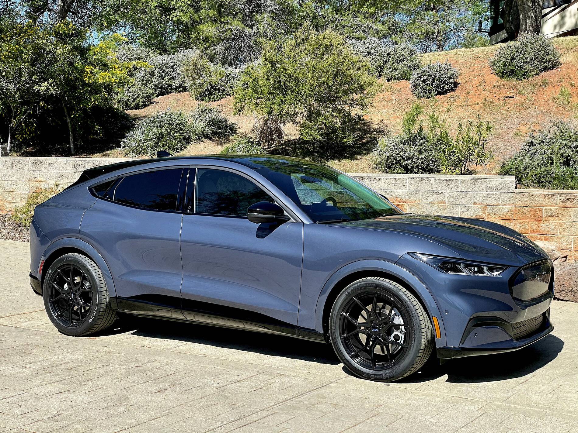

This is your fault! My GT is probably showing up this week and now I can't decide if I want to do this to my ride before I get it ceramic'd. It... it looks soo smooth like that!
Quit debating. You can touch up the ceramic later, but if you're thinking PPF, get those badges off first.
dwiz49
dwiz49
55
PA
2021 Mach E
Your car confirms my decision to debadge. Looks fantastic!
