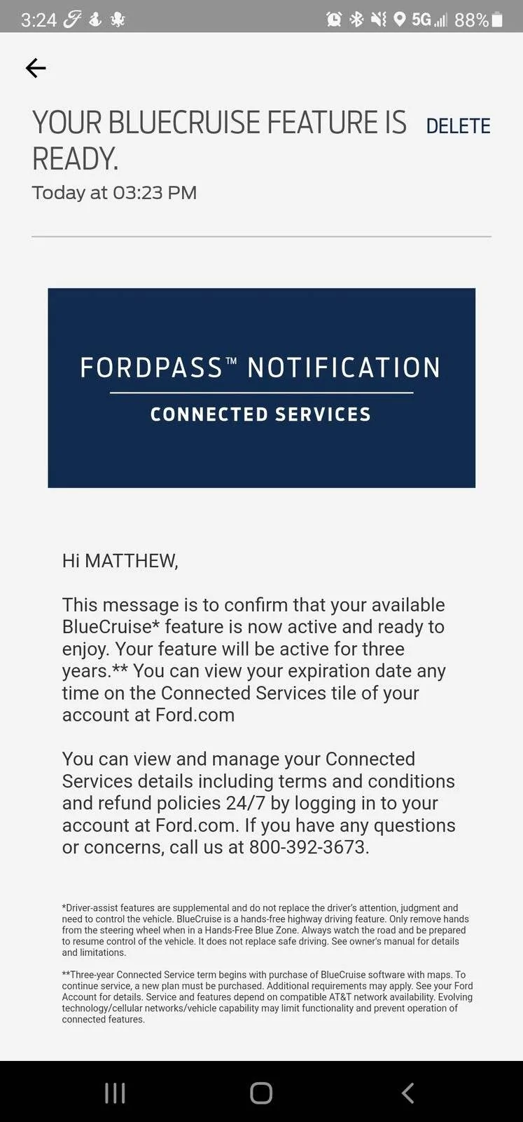

Just got a notice that Blue Cruise had been enabled on my GTPE. Used it during lunch today.
I got the same message in my Ford pass but I don't see where it is on the car.

Same thing for me. I got the message that it's ready to use and enjoy for 3 years. But even on a major freeway (Rt 101 on the west coast) it never kicks in. Don't know how to tell if it's truly onboard, or how to engage it. Also have no idea which of the roads on my trip are "approved" for BlueCruise use. Is there a reference for us to see where it will work?
It has to be a true "limited access" highway (only way to get on/off is via ramps). In Michigan, for example, US-127 has sections that are limited access ... but in other sections there are intersections (cross-roads) where you can enter/exit without using a ramp. Coverage on that road only works in the areas that have ramps and it stops working as soon as you get to an area that has cross-roads.
A while back I saw one image (clearly meant to advertise the coverage) and it wasn't highly detailed ... but it was detailed enough that you could sort of figure it out because the highlighted routes (though not labeled) matched where I knew the major freeways were located in my area. You can find one here: https://www.techrepublic.com/articl...-off-driving-feature-is-a-solid-first-effort/
Even though that's not very detailed, it is detailed enough that you can see that most of US-101 is not a "Blue Zone".
Get on covered highway and activate cruise-control. Instead of getting the "hands on" image, you should get the "hands free" image on the driver display.
