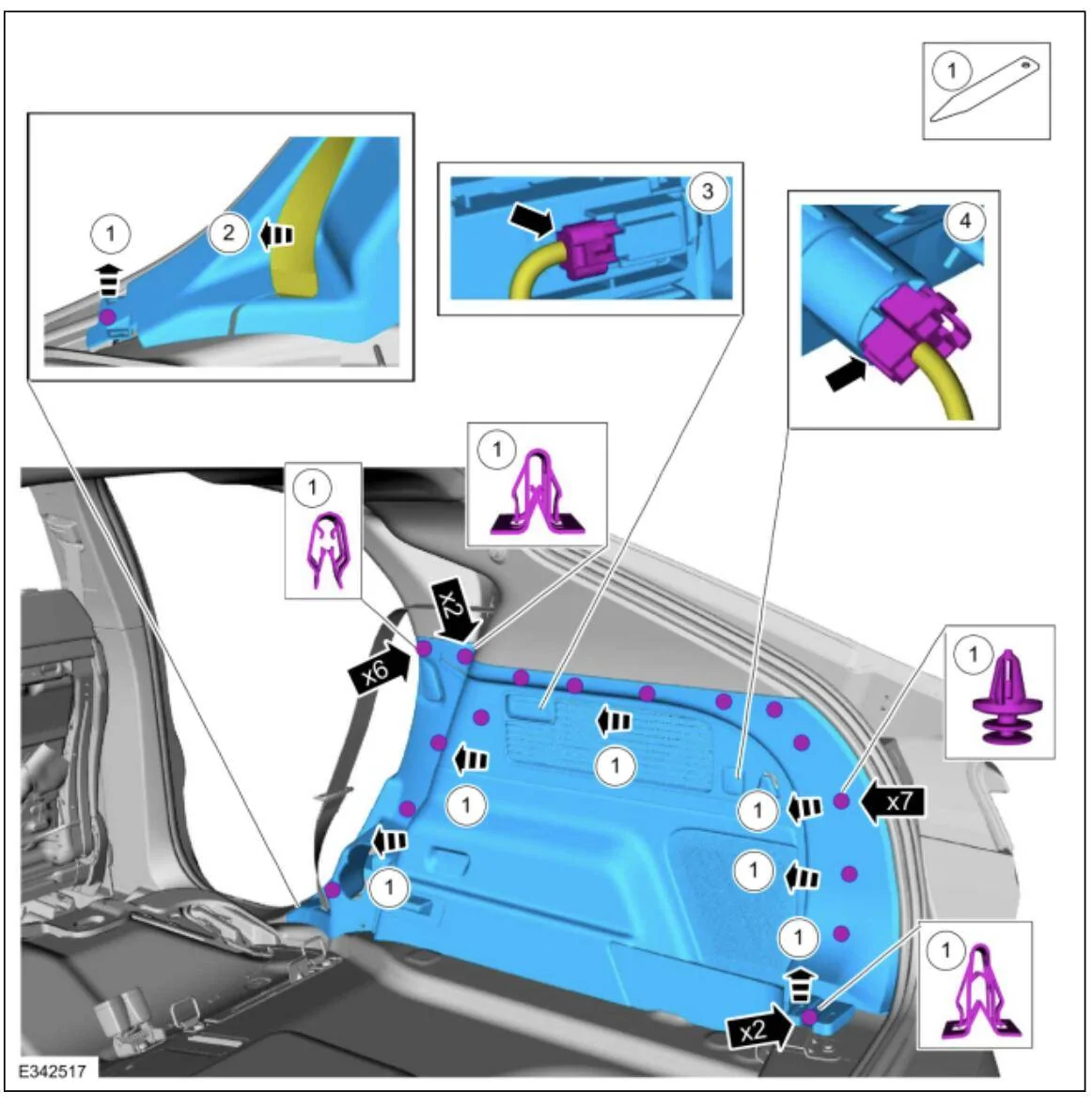

On a side note how hard was it to remove all the trim to dynamat the whole car
Extremely easy. Pull the weather seal up and pull the side panel off. I did not remove the panel completely. Only had to enough to get back in behind it to put my arm through a large hole to apply the soundproofing. There are just clips holding it on, no screws.

Can I ask where you got these diagrams from? Service manual (I assume it's on this forum somewhere... I just haven't looked yet)?

Yes, I use only JLAudio amps and subs. They have line level inputs as well as low level. After a bit of figuring out what size I wanted to still maintain the dual level of the cargo floor, I decided on the JLAudio ACS110LG-TW1 sub/amp combo. If I were to keep the cargo floor on the upper level I could have gone with a larger sub or even dual subs. Not interested in that. Don't need the output with this system. Just looking for some actual low end bass. I just got through running the power wire from the battery and the OEM sub wires for the audio signal so all ready to drop in the sub when it gets here on Friday.

I’ll post photos when Install the sub on Friday. I’m just replacing the styrofoam container below with the sub.
