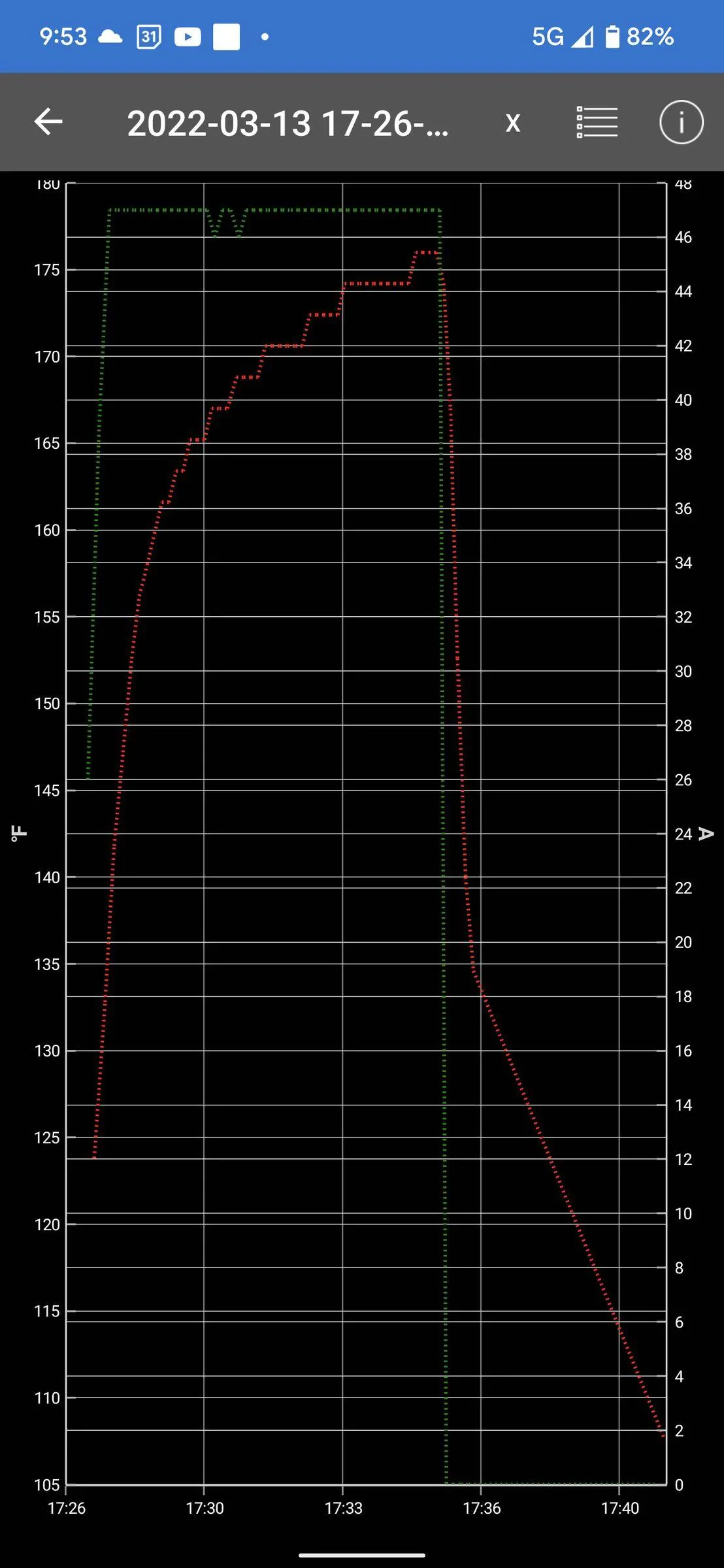

I don't know how hot the on board charge connection should get while charging, but I did hold my hand to it after unplugging and noticed that it was almost too hot to keep my hand there. If anybody has any specs to point to I'll check it with a laser thermometer.
I think it can get pretty hot. I'll post a graph of mine charging at 48A that eventually got too hot at around 175F. At 32A it was hitting about 130F.
However, this was the data before I had the charge port replaced under warranty. I'll try and get recent data to see if it's still that high.

I finally found the senors in car scanner. The AC coupler temperature on mine was climbing over 240F on one sensor before I had to get out of the car. I'll do a more thourough test on the temperature later this week when I have the time.
Holy s***, you need to get that replaced ASAP. You will probably need to buy a new EVSE cord as well since that probably melted too. Why don't you carefully inspect the charge port and J1772 for signs of melting?

I think he's looking at a post of mine from last year.
It turns out that, in my case, the temperature wasn't really getting that high in the charge port. There was a faulty temperature sensor that was reporting temperatures much higher than were actually present and causing the charging session to shut down.
They had to replace the charge port and the entire cable that goes from it to the onboard charger to fix the problem. Mine has been find ever since.
