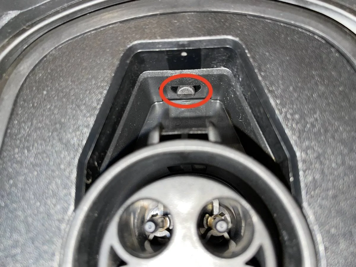

I was having random Charging Fault errors with my home L2 Wallbox. Dealer determined it’s the charge port lock actuator. Part is on back order right now but hoping to get it next week.
You can stick your finger in there and feel if the actuator is in the way or not. Below picture is an undamaged example in the fully retracted position.
