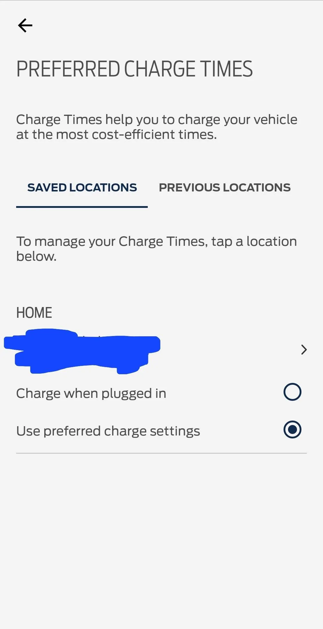

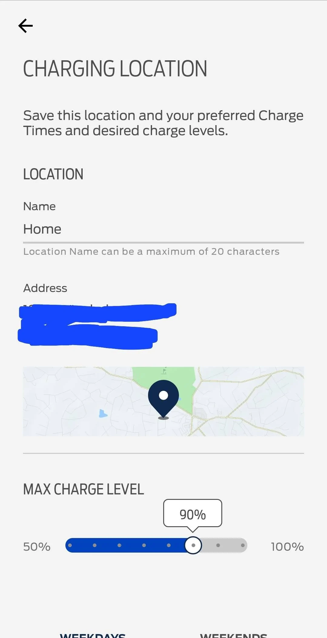

Did you save your home location?
Ford Mustang Mach-E Charging at home, ack!!!! Screenshot_20221008_121418
Ford Mustang Mach-E Charging at home, ack!!!! Screenshot_20221008_121329

1. go to the car.
2. From the car’s big screen: Delete the charge location
3. Plug the car in and let it start charging for a few minutes.
4. Unplug the car.
5. From the car’s big screen: Save that new location as home and set your max charge to 90%, selecting your prefered charging hours. Save these settings directly from the big screen in the car.
6. Most importantly : Ignore the FordPass app for all charging settings, charging logs, driving logs, or anything that involves a number
