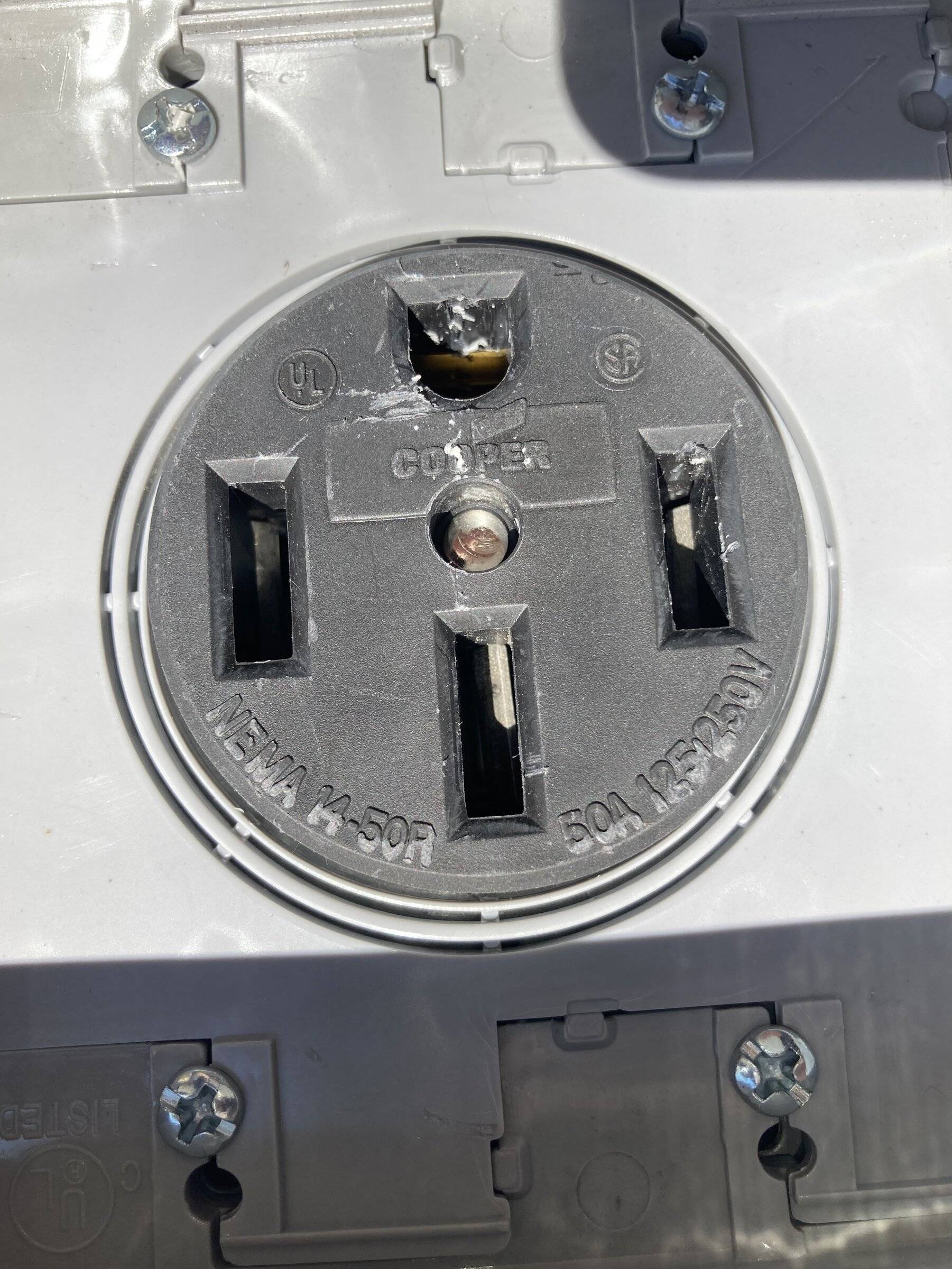

Thanks again. I guess it is not correct, socket says NEMA 14-50R (rotated image below).
Well on a good note, that looks like a good industrial outlet, not one of the cheap box store ones like I installed. ?
Is it possible that outlet is on a 50 amp breaker installed in the same box the outlet is in? The picture you provided looks like some sort of subpanel so maybe he ran a 60 amp circuit for a direct wired charger, and ran the outlet off a 50 amp breaker in that subpanel. If that is what he did, you are in good shape. That is exactly what I did, BTW.
Also what I have, same setup
