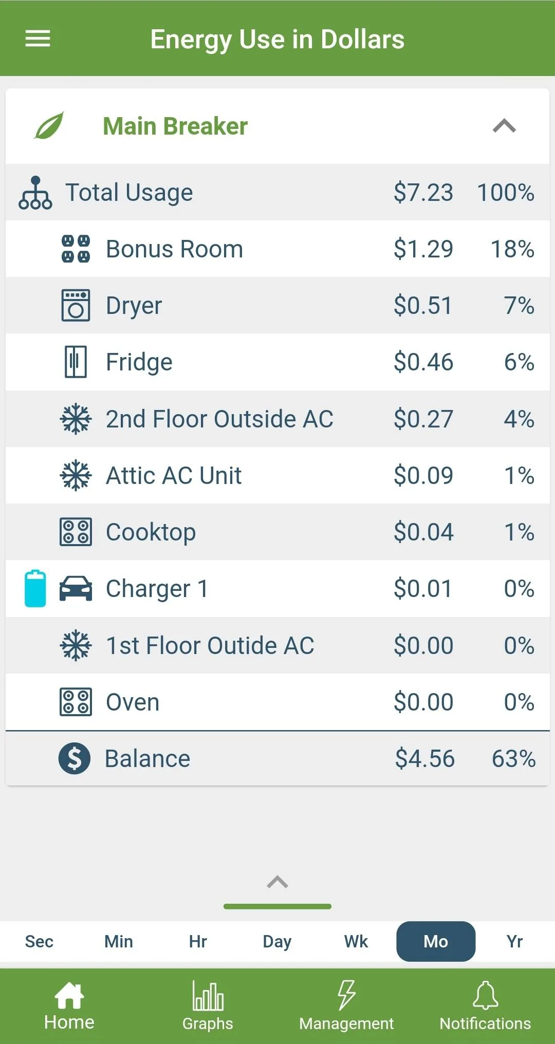

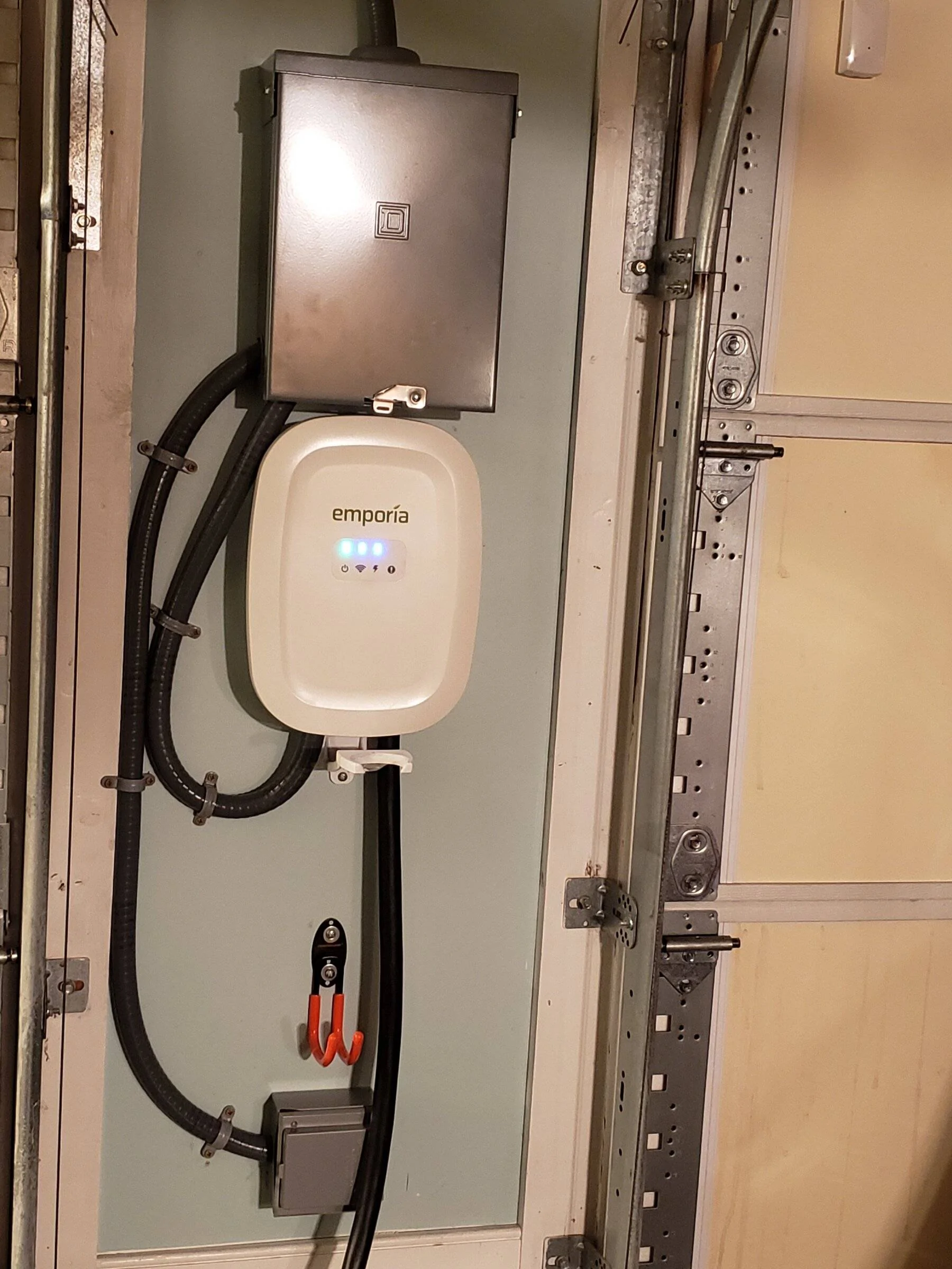

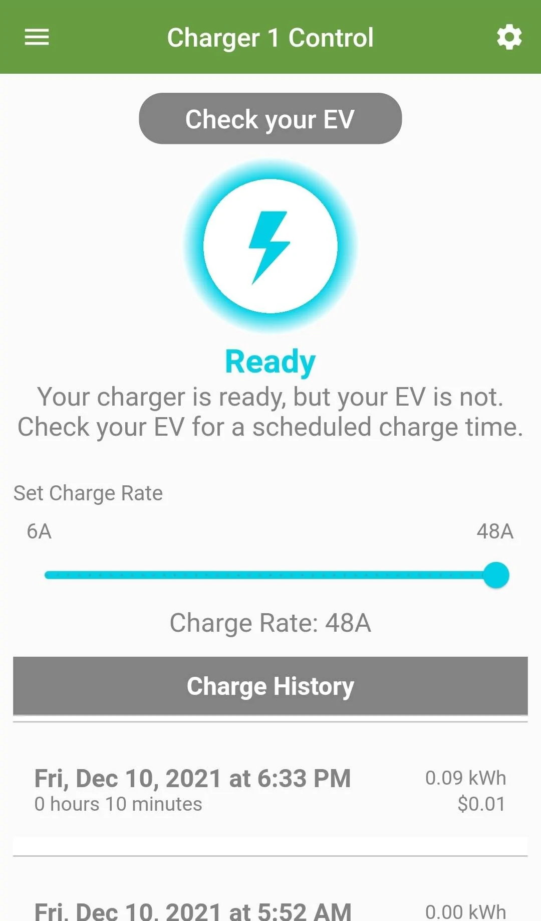

Check out what Emporia is offering. I have their charger and it is Wifi enabled and linked their their power monitoring app. You can hardwire it or plug it in. The hardwire lets you charge at 48 amps. I am very happy with it.
https://www.emporiaenergy.com/emporia-ev-charger
Check out what Emporia is offering. I have their charger and it is Wifi enabled and linked their their power monitoring app. You can hardwire it or plug it in. The hardwire lets you charge at 48 amps. I am very happy with it. Get 30mph.
Have the same unit. cost less than Ford or flex point and very happy @ 40amps w/SR battery.
