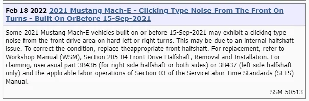

I took it in to the dealer and handed them the SSM below. It took them less than an hour to confirm the issue, and they returned the car to me to drive until the parts came it. About two weeks later they called me to schedule an appointment to replace the half shafts. So easy.
Thanks Mike. This is gonna be my second dealer I’m trying so I’ll print that out and hand it to them. It occurs mainly on the left side when making a U turn. Right turns don’t make the noise from my testing. Hoping it’ll be a quick diagnosis.
Try to get them to replace both sides. If the defect is on one side, it is likely on the other as well.

I hate to say it, but it is most apparent when turning, and sharp left turns are more common than sharp right turns. Like an aggressive U-turn, which is when I first realized I had the defect. But if you do a similar maneuver to the right, I bet you get the same sound.
Replacing both should be standard procedure.
