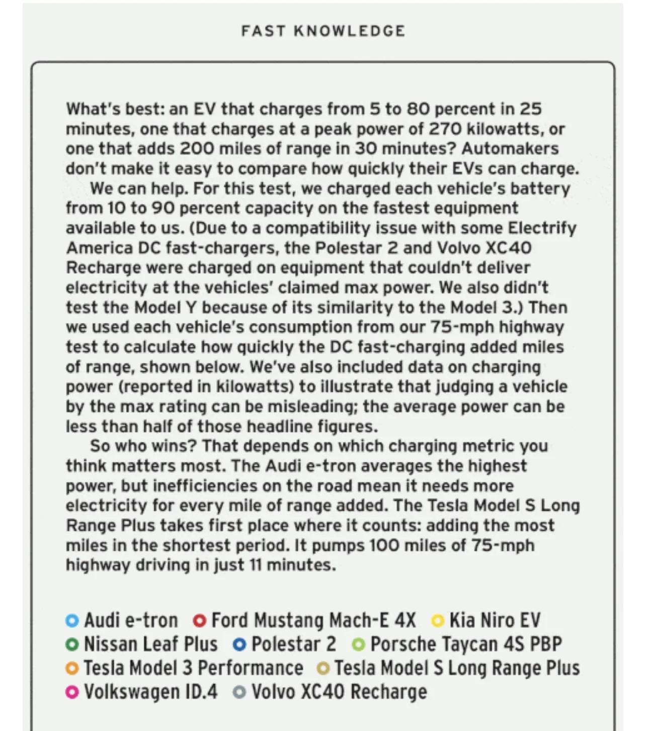

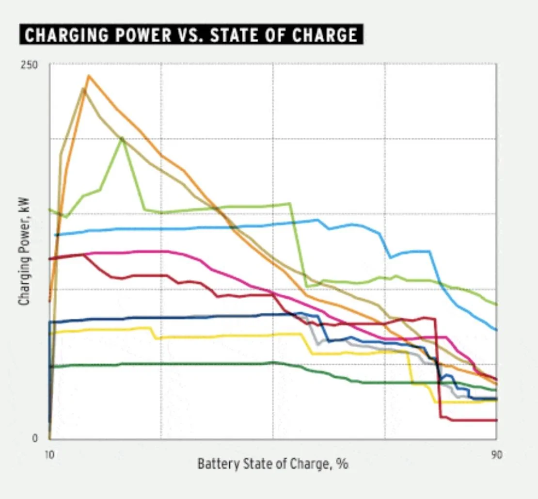

Really explain for those not so good in math. If I can do 70 miles on 70 KWh I can't get 90 miles on 90 KWh? How does consumption work? Inquiring minds would like to know.
It’s extremely hard to follow what you are complaining about to be honest, I’m assuming English isn’t your first language. I’m not trying to be insulting by saying that either, it’s just difficult to follow the point you’re trying to make here.. the MME will DCFC to 100% of the usable battery capacity. Consumption has nothing to do with charge speed. All electric cars charging speeds on DCFC reduce as state of charge increases. There are very well documented graphs provided by car and driver (below) among other sources like InsideEV. They also recommend only DCFC to max of 90% total usable capacity, not because you can’t charge more but because it damages the battery to charge quickly above 80-90% frequently. It is a by product of battery chemistry and requirements for the batteries to last a certain amount of time without needing a replacement, smart phones do the same thing with smart charging to preserve the battery life. Similar to manufacturers recommending not driving an ICE cars at redline RPMs all the time.
The Mach-E just has/had a significantly reduced rate of charge after 80% of usable battery. Also, usable battery will not likely ever increase much. Again, all EVs have a portion of total battery capacity not included in usable space as designed for longevity purposes, it’s not unique to the Mach-E. The Mach-E will likely have much better long term performance of the drivetrain all things else equal because of that larger reserve capacity.
You know when you have to resort to making personal comments about someone character you lost the debate. Not trying to be insulting by saying that either.
I pre-ordered a 99 KWh battery to travel. That went down to 88 KWh useable with a larger than expected buffer after ordered and now I am only able to charge that 88 KWh up to 80% for travel by all practical purposes. So only 70 KWh useable of the 99 KWh pack when you need it on trips which is less then the model Y 75 KWh and a whole lot less efficient.
The MME does not DCFC pass 80% right now it goes down to L2 level charging after 80% and is therefore close to useless and not my definition of useable for the top 20% of an already large buffered pack. Shift the L2 cliff at 90% would be an improvement but still not a selling point and poorer than any other EV in your graph.
