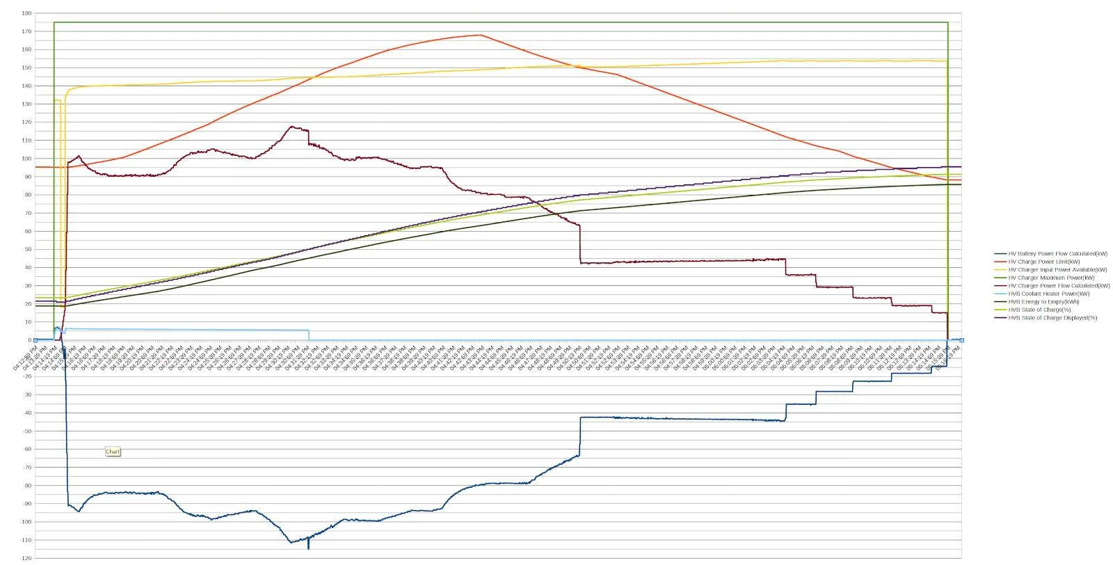

I decided to test the new updates on a DC Fast Charger. It was in the mid 30s F so I set a departure time to take a trip with charging along the way. The cabin was nice and warm although the HV battery temperature was only in the 50s. It was about 40 miles to the EA charger. I used an EA charger due to the free weekend. I rolled into the charging spot with 22% displayed SOC.
One new thing I can track is the HV Battery Coolant Heater Power (Lt Blue) and noticed the car will request 6kW more of power to cover the heater. The spike in the power to the battery is due to the heater turning off, so more power briefly goes to the battery. The HV battery temperatures went up during charging and there was active cooling in the later part of the charge. I think that is why the HV Charge Power Limit (Orange) was lower to start out and peaked as the battery was up to temperature.
I find it interesting that the SOC Displayed is in 0.5% units and you can see the steps in the chart. I only charged up to 95.5% SOC Displayed. This gives a 91.26% SOC value and 85.68 Estimated kW to empty. This is around 1.6kW higher than I would expect for 88kW available.
The drop at 80% SOC Displayed is still there, but I can live with 42kW. It is too bad they could not just continue the downward slope until it hit 42kW.
I am still working on an update for Torque Pro. I need to figure out a few more useful data items.
Thanks for the data to confirm a charging curve update, I updated the #1 post with this information. It also appears that you may have 91 kWh pack capacity enabled now as well, as the usable capacity has increased beyond 88 kWh. We need some southern folks to test this in 70+ºF weather to see if 90+ kWh has been achieved, since cold weather may have decreased Eric's pack capacity reading some.
Eric, could you provide the charging data in spreadsheet format? We might be able to figure out the buffer capacity from your displayed and real SoC data to confirm a capacity increase.

Interesting! Curious to see if other people can confirm this. Do you have the full charging curve of that session?

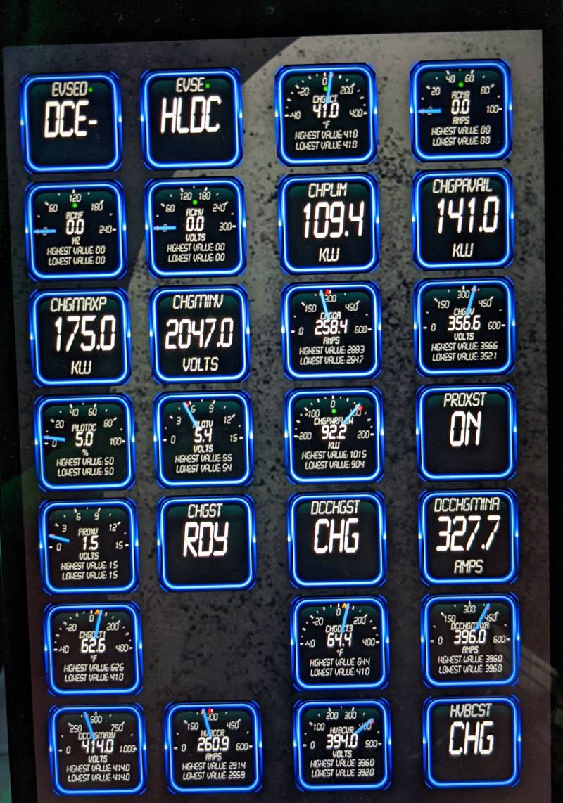

Where can I see this data shown in these images
Am I reading this right? Looks like 35 minutes to go from 22% to 80% (adding 58%).
