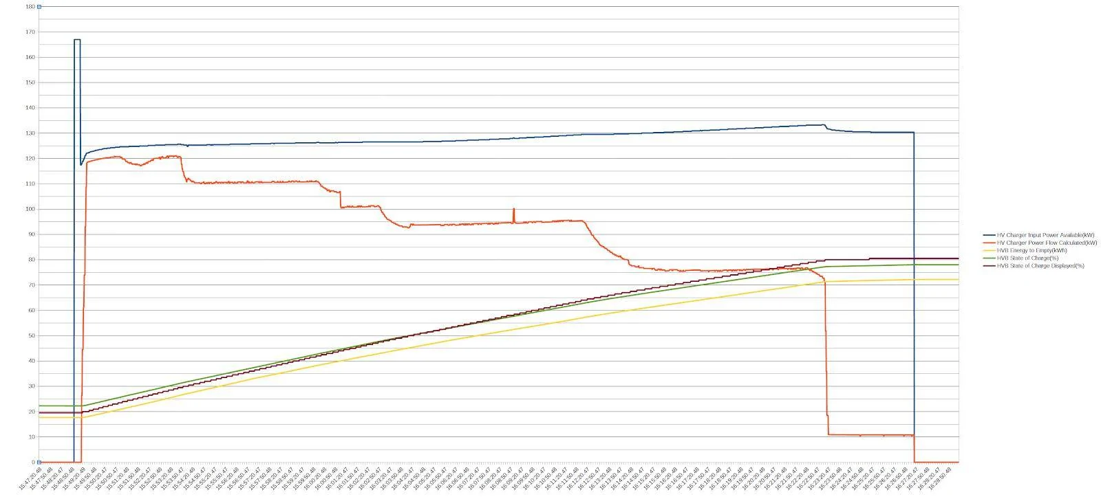

Here is the charging curve I got with the October Update. Temperatures were in the lower 60s. There is still a big drop at 80%, but it seems to have the slightly increased capacity. It does look like the November update has an even better charge curve, but warmer weather is needed. Maybe a trip to Florida in a few months.

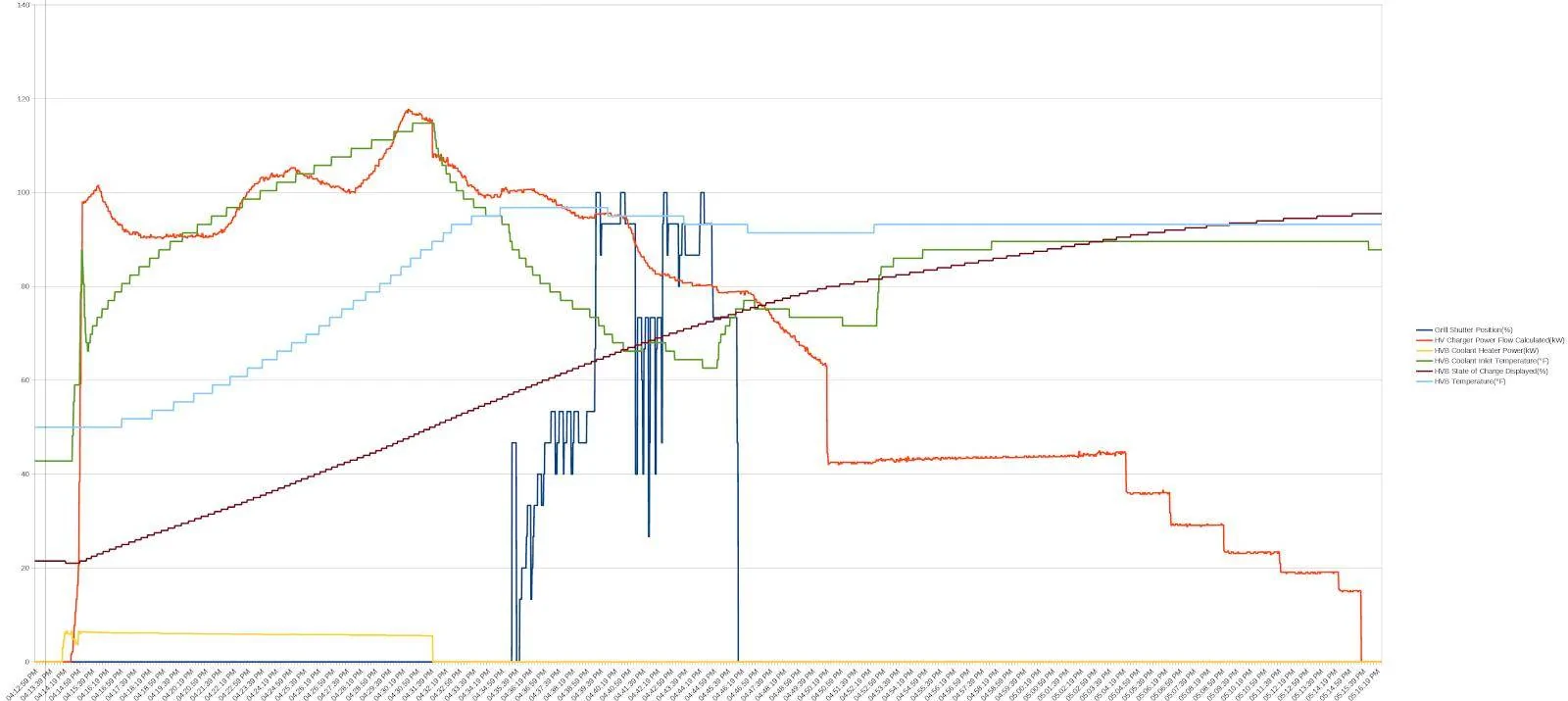

I graphed a couple of temperatures from my Sunday DC Fast Charge. The car likes the HV Battery temperatures in the 90s F when charging.
That's the charge curve I want. I still have the 80% cliff.
