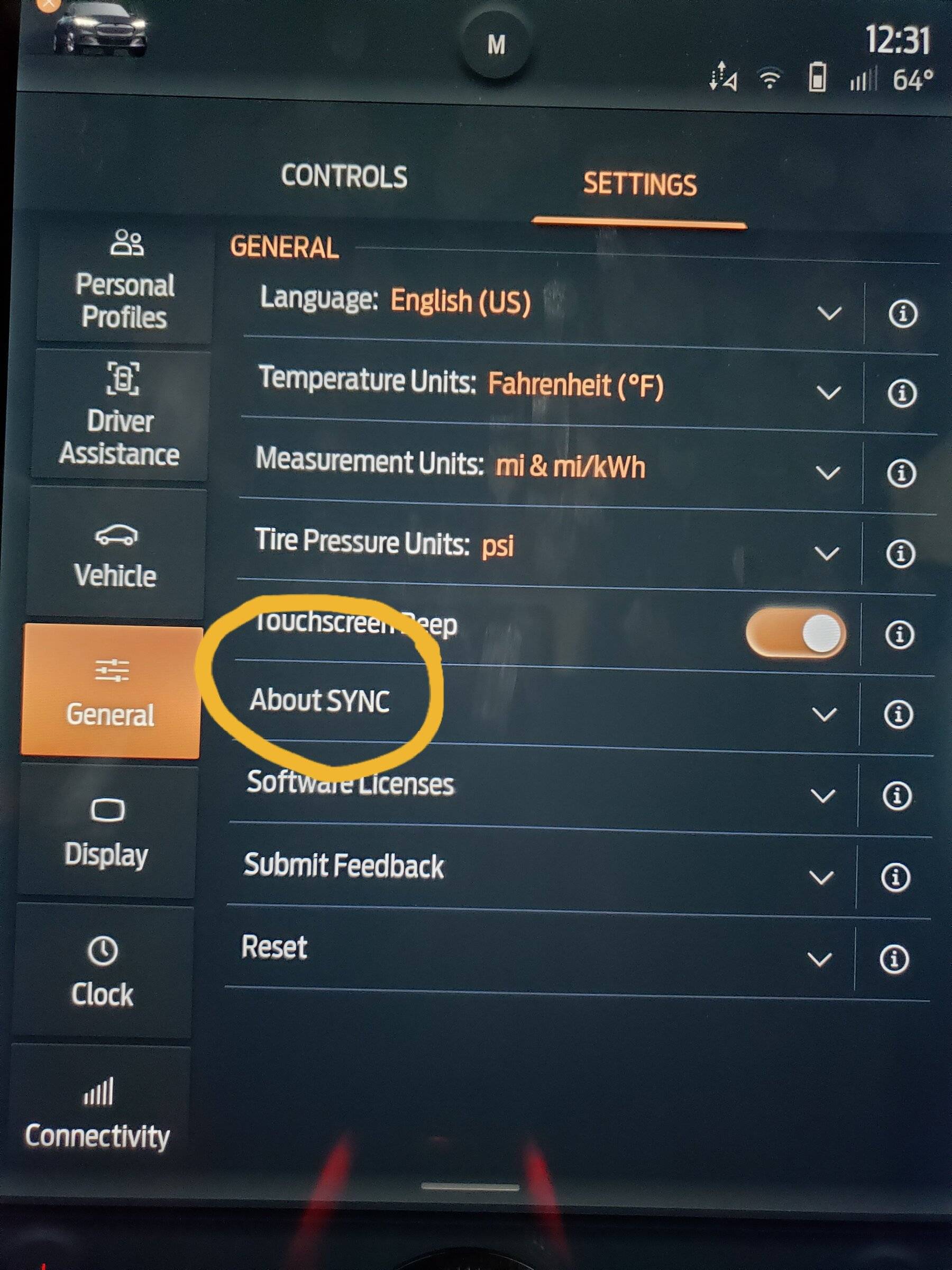

where do you guys see what version of Sync you have? I have a July build Premium MME and it just says "system up to date" on mine.
If it says System Up to Date that just means it has the latest version that was installed since it was built. I have a July build as well and I just got 1.6 and 1.4 in a row (in that order, it's normal). I'd expect you to get that soon as well before you get 1.7.1 unless you have Securialert already in FordPass app, then you're probably just waiting on 1.7.1.
Ford Mustang Mach-E Customer Satisfaction Program 21P22 - Software Calibration Update 20211202_123349

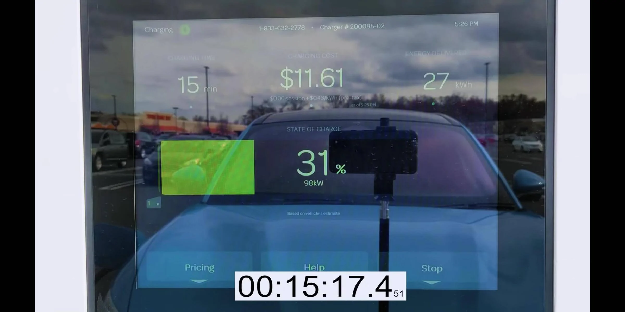

Kinda looking like that charge session was limited by cold battery. The heater was running up until the session hit its highest charging speed, then shut off. But it was already to the taper point by then so it never could go full speed.
Maybe, but @kltye got the same result twice in his sessions, even after the battery had been warmed up. I guess I'm just really hoping to see a good example of the improved charge curve shaving time off the 10-80%. We're usually seeing 42 mins or so on the original profile.
Darren Palmer said the MME was originally set up to get the best conservative 15 mins and 10-80% times they could out of the gate.
Original 15 mins per Tom Moloughney test = 27kWh.
Ford Mustang Mach-E Customer Satisfaction Program 21P22 - Software Calibration Update Screenshot_20211202-094909

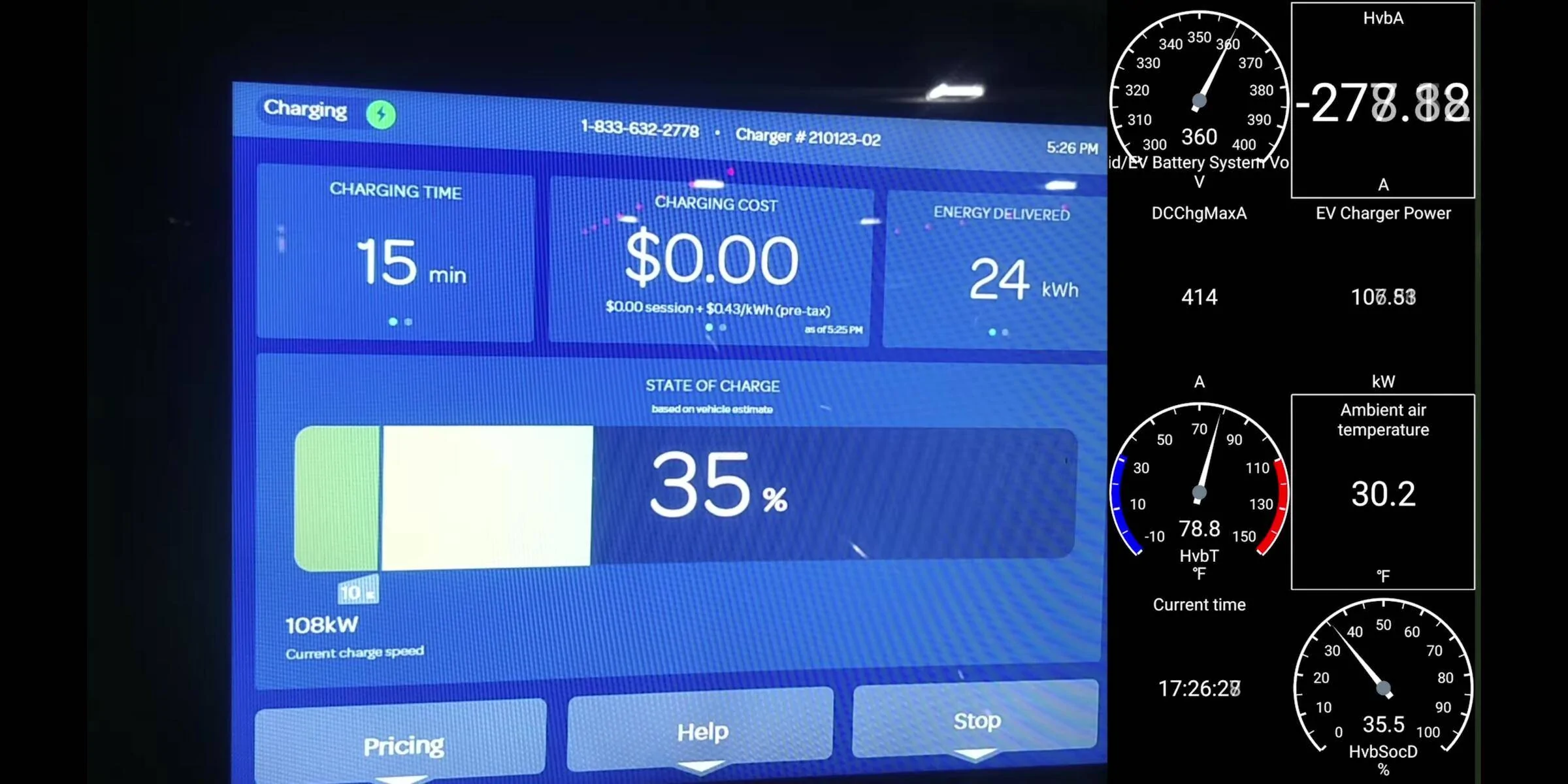

@kltye test on new profile is 24kWh.
Ford Mustang Mach-E Customer Satisfaction Program 21P22 - Software Calibration Update Screenshot_20211202-094709~2
Your graph shows it never got over 115kw. This is why its getting lower kWh in 15 minutes.
It would be pretty bad if they lowered the max charging speed from 150kw.
I'm not alarmed because we only have two examples so far but I'm also not encouraged yet. We need more data!
My battery was cold gating right at the start, so that's why there's a 3kWh difference between mine and Tom's test at the 15 minute mark. I restarted the test halfway through the video, and it held 150-ish kW for about a minute or so, which is what I've always experienced with my particular MME.
