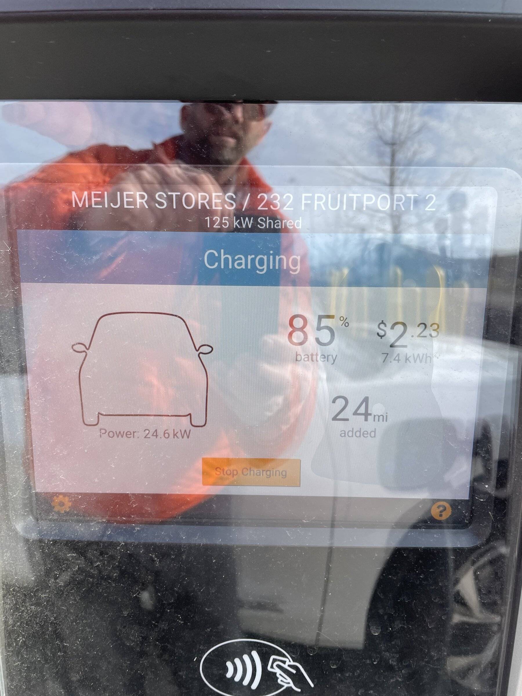

update: software updated. Range looks much more 203 miles at 82% SOC, and just charged up at a charge point and although rate of charge dropped a little, was still getting 24kw charge rate at 85% SOC
