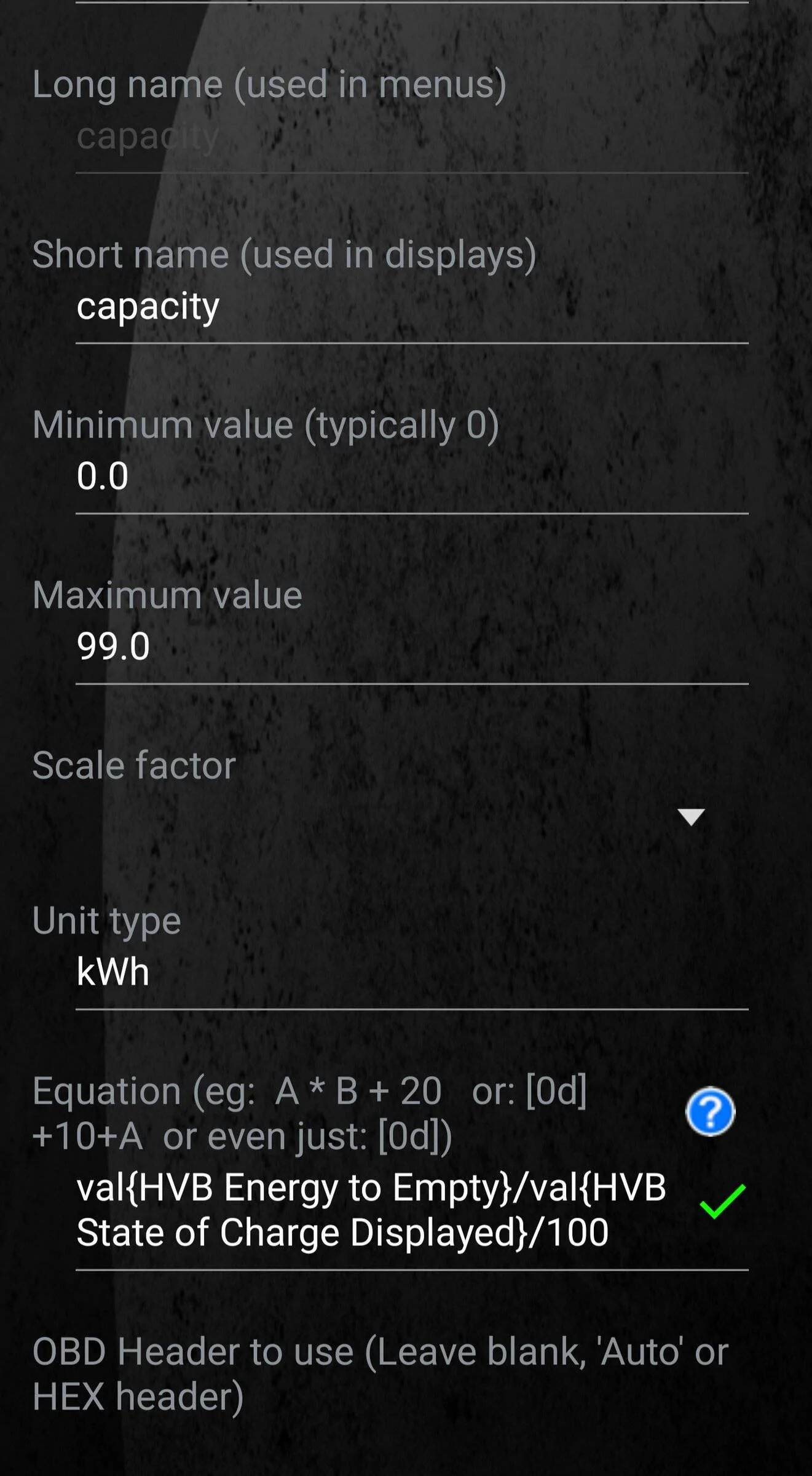

Got 21P22 yesterday, I wanted to confirm if it increases usable battery capacity to 70 kWh from 68 kWh. I cannot conclude anything using Car Scanner when I compare the actual SOC displayed with the real SOC %. I had a few old Car Scanner screen shot and my numbers are pretty close. But if my numbers were good, it seems that the buffer was more at the bottom of the battery than at the top because my actual SOC showed 96% when I charged to 100%. That doesn't leave a lot of capacity there. I don't have data close to 0% to compare.
Is there a way to confirm that my usable battery capacity has increased in Car Scanner?
You can create a PID to track the capacity. Its basically taking 2 values and doing a calculation on it. It does fluctuate around as that HVB Energy to Empty value seems to fluctuate sometimes. At 90% SoC currently it was jumping between 79kwh and 83kwh. It seems the most inaccurate during charging.
This is on torque, but you should be able to do something similar with other apps that allow custom PID's.
HVB Energy to empty divided by the displayed State of Charge divided by 100
Doesn’t work at all for me. 49 kWh remaining, 79% SOC (real). It would translate to 62 kWh usable. Not sure if the cold have an impact on this. Today my trip indicate a 8% usage for external temperature. That date was never clear for me.
