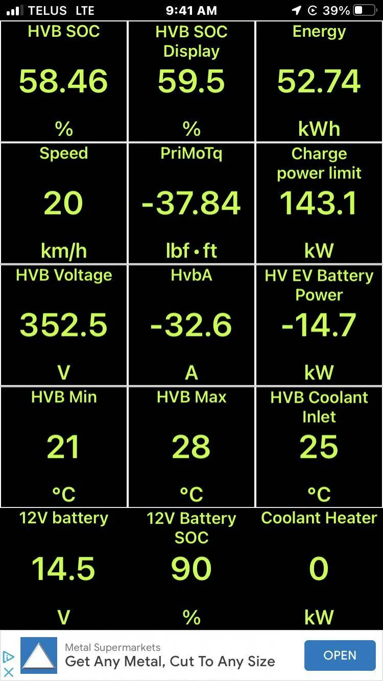

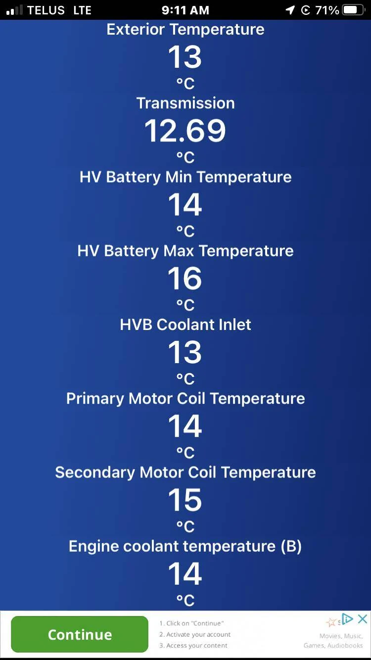

Just trying to understand what the battery minimum, battery maximum, and coolant inlet temperatures mean?
The first pic is when I left home this morning. I used the Ford navigation and selected a DC FC within 30 km of the house.
The second pick was in transit. I noticed the first thing to rise in temperature was the HVB coolant inlet, it actually reached 44°. The next thing to rise was the HVB maximum temp. and then the last thing to rise was the HVB minimum temp. Based on the numbers, I am assuming the preconditioning while in transit to a DCFC must have worked? And that it wasn’t just me doing regular driving that was heating up the coolant and battery? I’m not sure what the ideal charging battery temperature is?
Your thoughts? Ty
