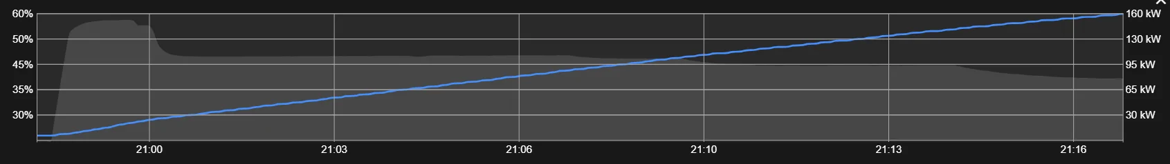

In France last month this is what i got (chargingcurve) measured by the OBD adapter. This was charging from 22% - 60%. My GT can handle the peak quite a long time, but averages around 100 kW. This is a 300 kW charger.
Ford Mustang Mach-E DC Fast Charging is always a disappointment. Fastned 300 kW
