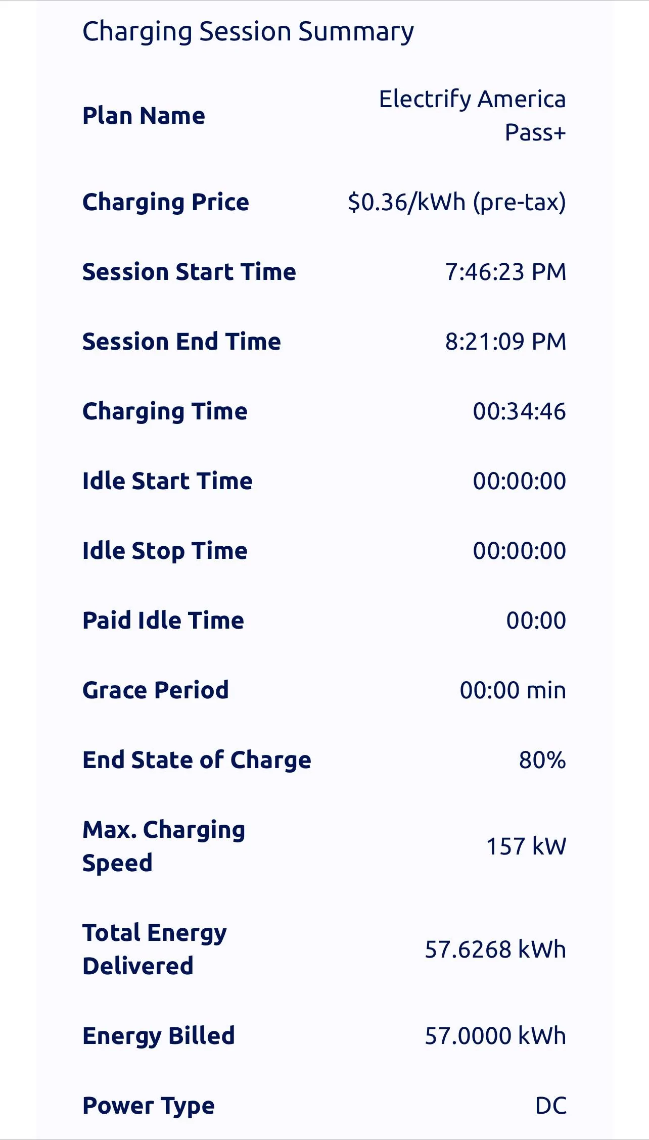

This week I charged on a newly installed EA 350kW station with no preconditioning and got 97.7 kW average between 17% and 80% SoC. 2022 Premium AWD ER.
Ford Mustang Mach-E DC Fast Charging is always a disappointment. IMG_2528
