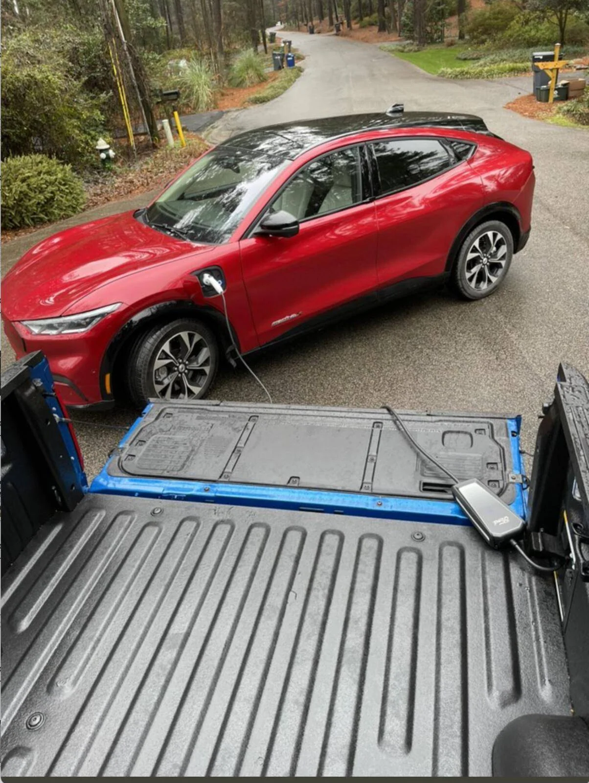

You mean like this.. :)

this image is AMAZING.... Ford should pay you for this Art.
I have a 120V plug in my Fusion Hybrid (dont ask), maybe i can replicate the image once i receive mine. lol
Okay, all of Florida's Road Ranger highway assistance vehicles should be Ford PowerBoost F150s. This is amazing!

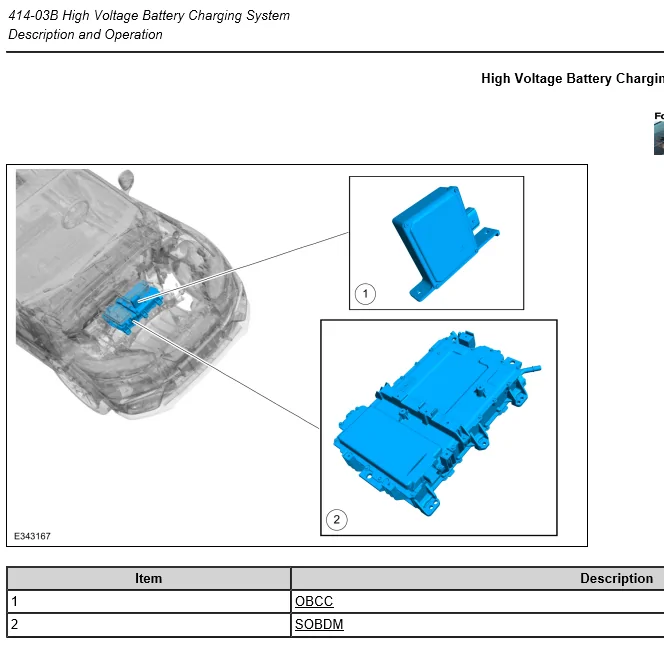

14B227 would be the DC to DC converter, that 10E994 is close to it. 10B689 is the charger module.
I’m told actually a gateway module, I’m wrong on the part I focused on.
highland58 has the correct part.
I told you incorrectly. The order sheet said gateway module but what you actually received is the OBCC (Off Board Charge Conroller). If I read the service manual correctly, this is for DC fast charging only.
The OBCC incorporates a Electric Vehicle Communication Controller (EVCC) to communicate with the Electric Vehicle Supply Equipment (EVSE) Supply Equipment Communication Controller (SECC) via Power-line communication (PLC).
That's a good illustration of why the frunk is smaller in person than we expect it to be. Even though there's no engine, there's still a lot of stuff tucked in behind it.
It's similar to why there is no Frunk in a Leaf even though there is no engine. Open the hood of the Leaf and it's full of STUFF!
