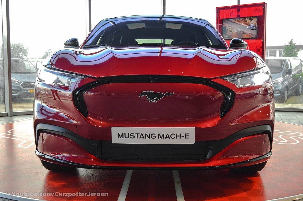

@Mopey's claim is still hilarious, though. Does it fit?
If the Mach-E was while with a red "nose', then it will look more like the clowns, especially Pennywise from "IT"!
