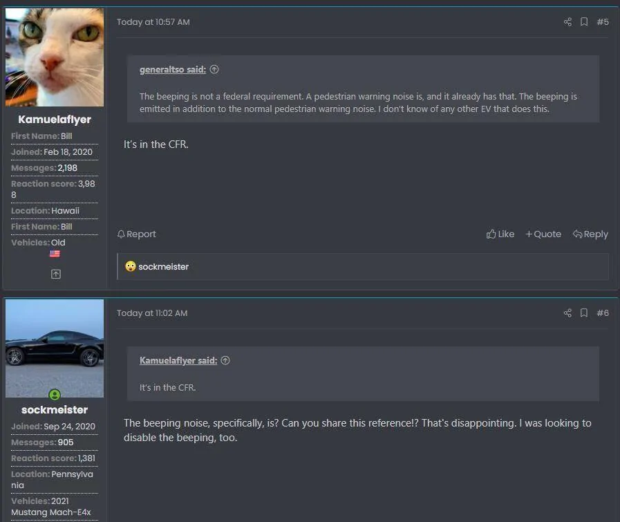

??? nothing seems to be missing for me. If you ignore people, their posts and quotes will "disappear" from the thread, maybe that's what happened for some of you?
They're missing. I had quoted one as a reply. We know who you are, Sir Hawaii!!! ? ?

GoGoGadgetMachE
Jan 23, 2020
153
5,609
12,661
like these posts I just did a screenshot of? maybe something weird with caching or something.
