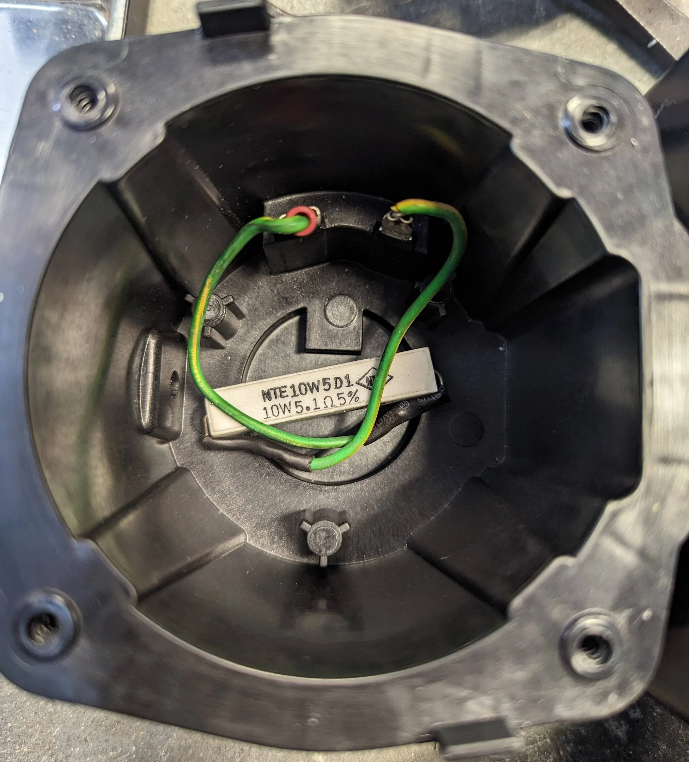

FYI, a 3.6 ohm 10 watt resistor does not work but a 5.1 ohm 10 watt resistor did work. And there is plenty of room to house the resistor above the speaker when all fully reassembled. The speaker is fairly small. Also, if you already have the frunk out, accessing the speaker is simple. A 12mm socket to remove 2 nuts is all it takes.

How many ohms is the speaker if you measure it with a meter?

I didn't measure it myself. Just went by what was mentioned earlier in this thread (4.8) and that a 4.7 ohm/5 watt resistor worked. My local electronics store didn't have a 4.7 ohm, so I tried 3.6 ohm 10 watt which triggered the warning on the dash and 5.1 ohm 10 watt which is working as expected.

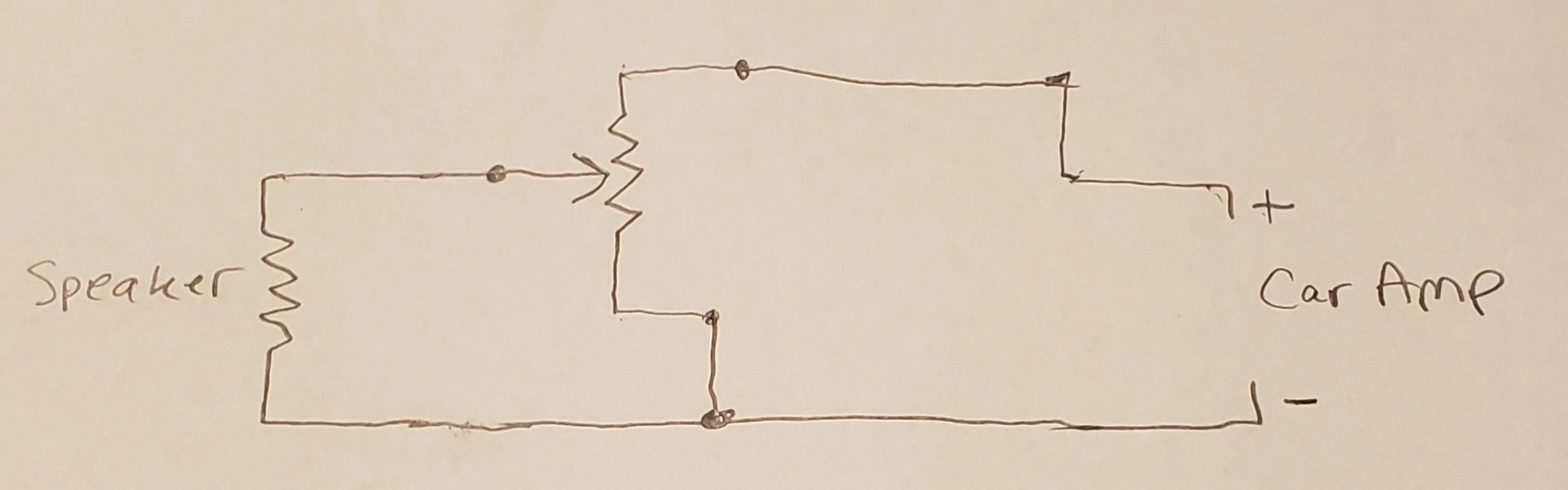

I used a 8 ohm potentiometer so I can control the speaker volume, and turn it all the way down. It works great. Maybe this week I will make a post about it, but here is the schematic:
Lol, I want a knob that turns it up louder too for when you get stuck behind people walking in the middle of the road or aisle. Sometimes they can't hear it until you're right on top of them. Then you can "rev" your engine too.
I saw a video where a guy added an electric bike bell to his EV. Hitting the button give a ding. He said most people respond positively to it with smiles and move over.
