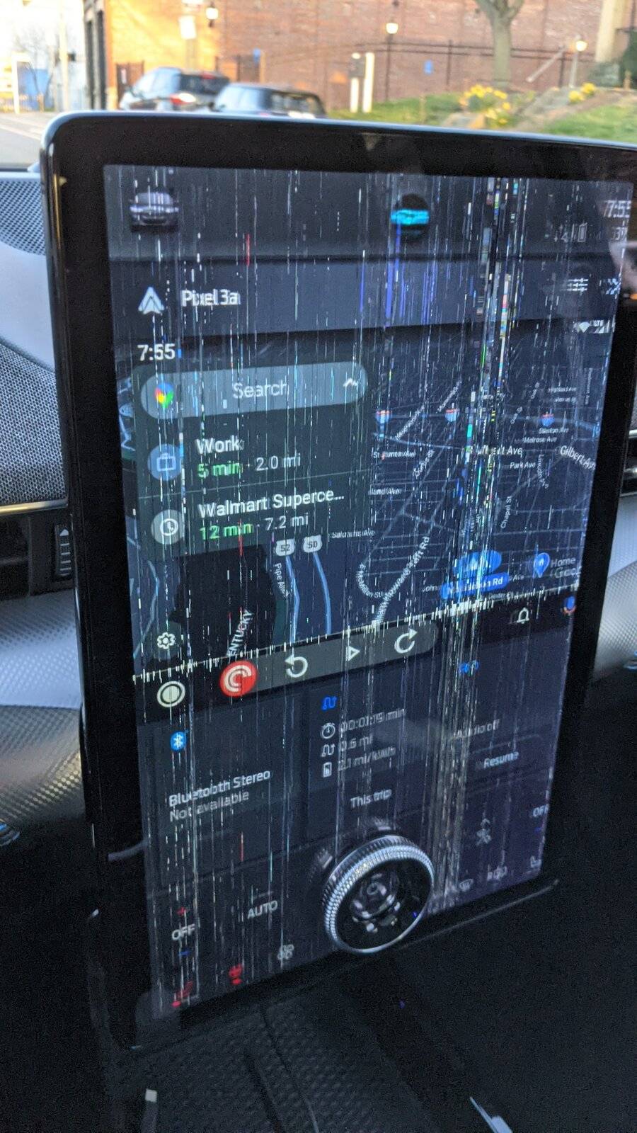

Ran into this myself this morning - GB FE built 1/9, had it about a week. Vertical lines, got progressively more scrambled until I did the soft reset. Cleared up right away, but figured I'd mention it here too. Grabbed a photo since I was at a light.

At least it won't take much to convince the dealer to repair/replace it if that problem persists!
