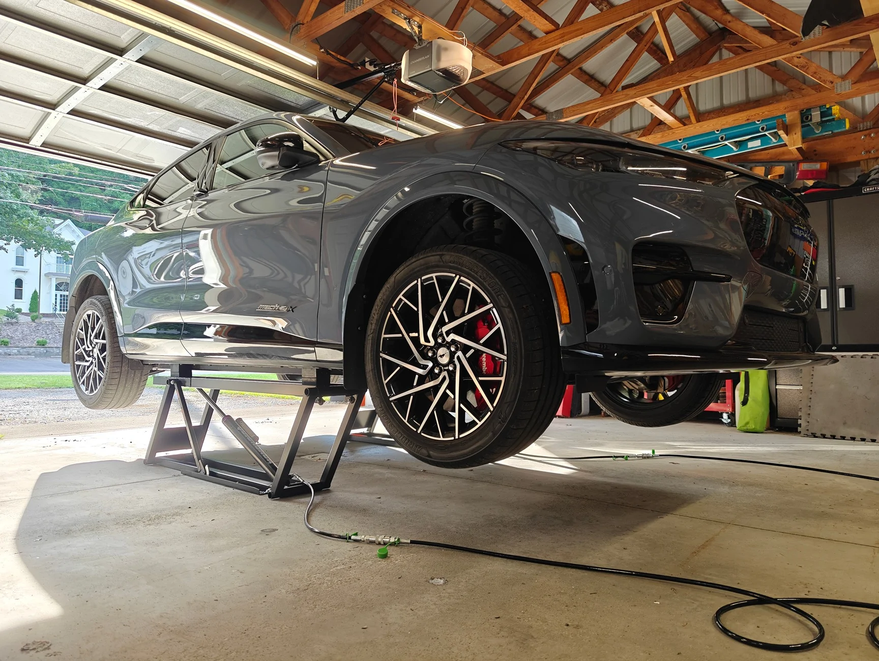

I own the 7000TL model and it works fine with the Mach-E. I do NOT use the Mach-E specific lift points but as long as you're not on the battery rail, it'll be fine. I don't use the rubber blocks - I use the SUV adapter kit to get the extra height (even though my photo shows the rubber blocks).
When I don't use the QJ, I use a cross beam on my Harbor Freight jack to jack one side at a time - again, as long as you're not on the battery rail, it's fine. I use this method when I want to rotate tires (and my tires are directional so I don't need to cross them).
https://www.harborfreight.com/steel-floor-jack-cross-beam-64051.html
NOTE: This is not professional guidance - everyone should consult their manual before before lifting their vehicle properly or otherwise.

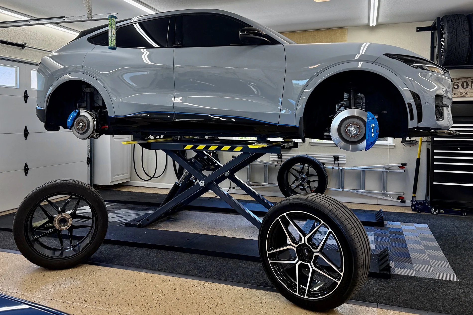

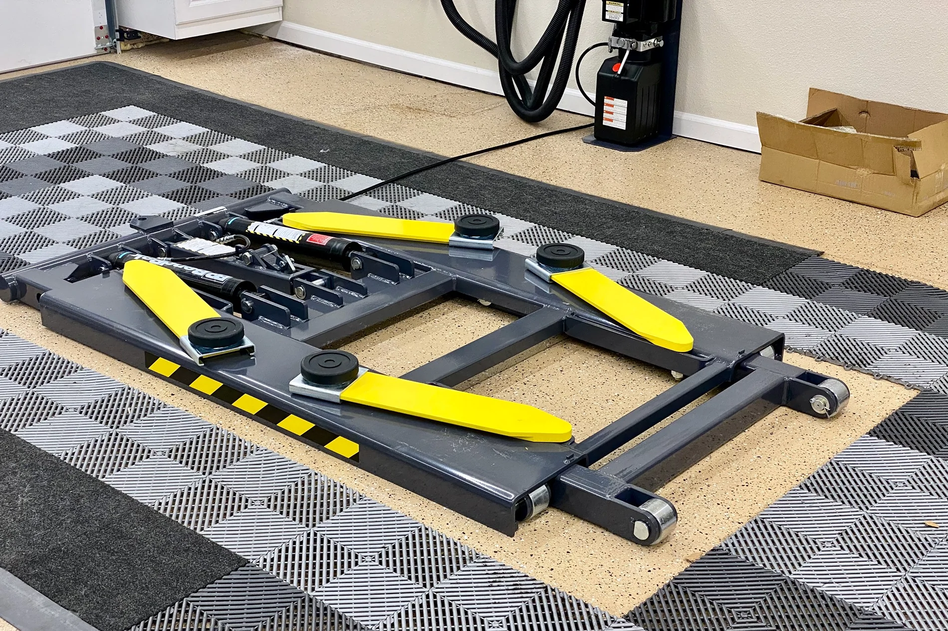

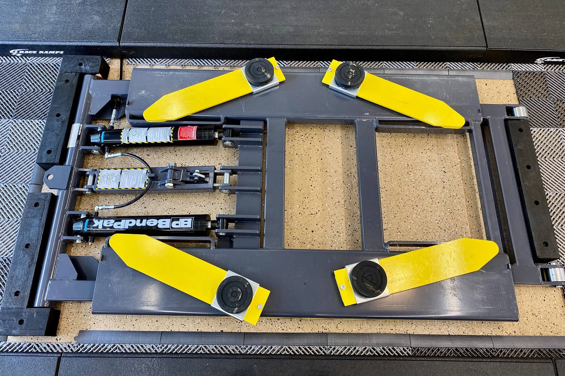

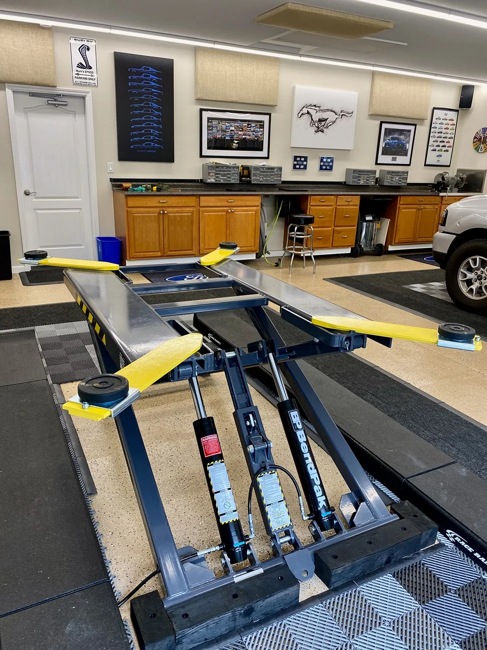

Don't want to throw a wrench in here but I have a BendPak MD-6XP. BendBak is the parent company of QuickJack. The MD-6XP is a mid-rise scissors lift with a 6,000 lb capacity. It has no problem swinging the arms out to lift the Mach-E (and many other vehicles) in the right position. I got this lift when it was around $3K about 7 years ago but they have gone up since then. Yes it is more expensive than a QuickJack but it's a really great lift if it is something you will use all the time, which I do. The center is not open but I don't care about that, especially with an EV. I use the QuickJack blocks on top of the lift's round pads. The pads fit perfectly at the lift points on the Mach-E.
They list it as a portable lift because you can roll it around with a special dolly that it comes with but believe me, at 1,000 lbs, it takes at least two very strong if not three people. I have mine positioned where I want in one of the stalls and bolted 4x4's to the garage floor front and back so it cannot move while going up and down. It has been the best addition to my garage (beside the mini-split). 😊
I have lots of photos working on cars while on the lift.

The QuickJack blocks work perfectly on the Mach-E. I’ve used them over a dozen times and they work like a charm. I don’t have the lift, only the blocks which I use with a floor jack. I keep them in the trunk in the same pocket as the mobile charger.

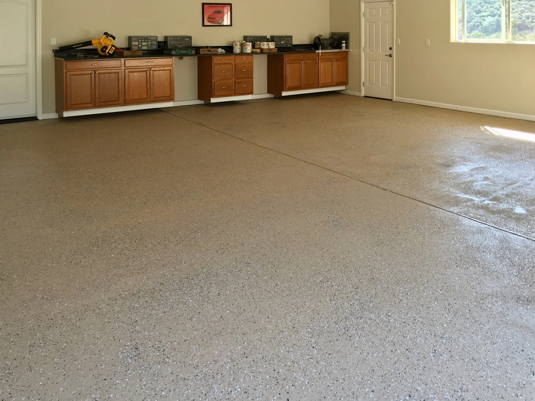

Mark, is your flooring coated with epoxy or polyaspartic? How long has it been and are you happy with it? It looks great in pics, but sometimes there are defects only you can see.
Note: my Mach-E is super jealous of yours. They were made a couple of weeks apart and are almost identical. But only one has a shitty garage (am still working on it) and has to endure harsh Midwest winters 😃
markboris
Nov 13, 2019
5,946
17,017
Sonora, CA

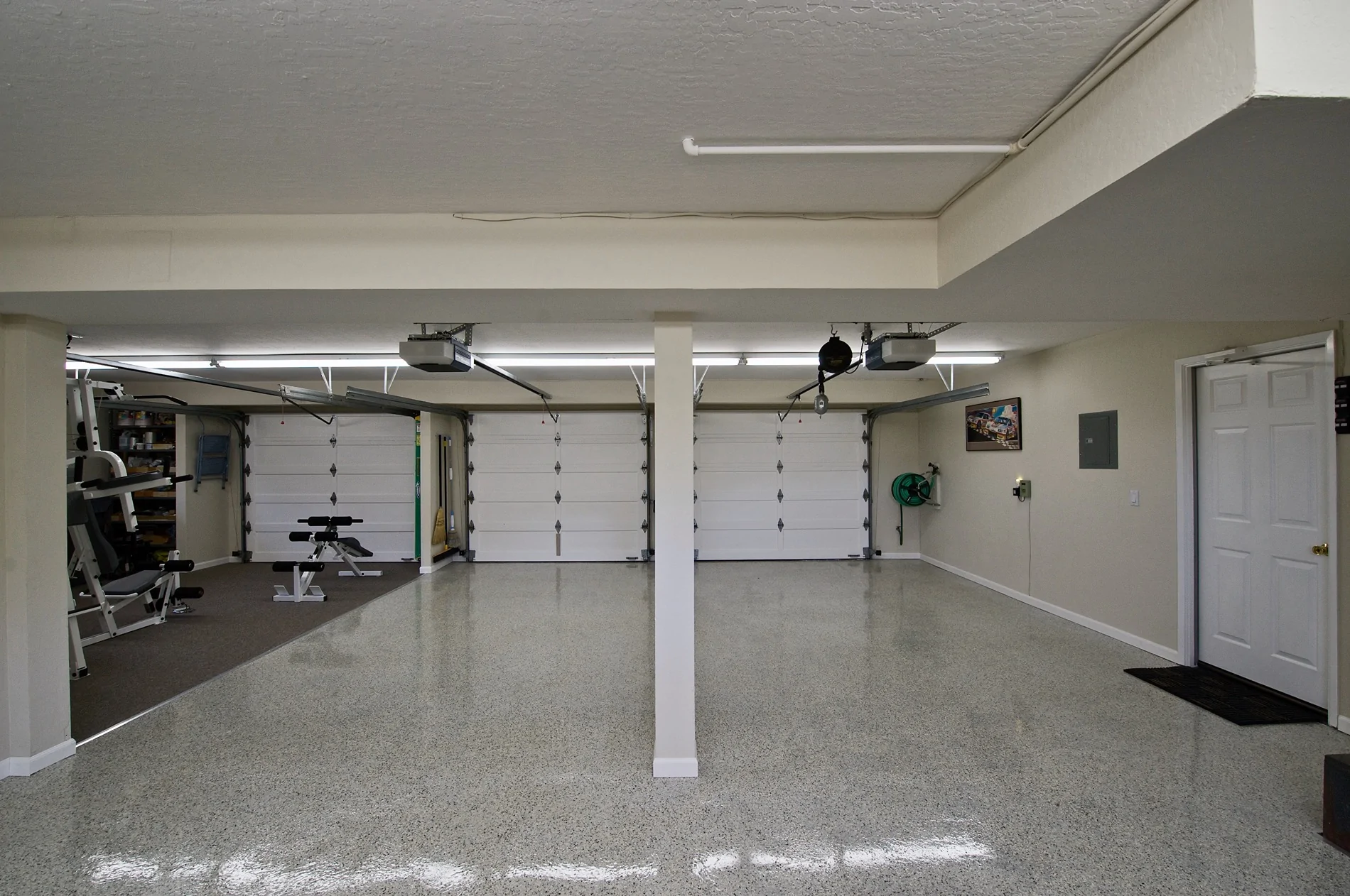

My floor is epoxy painted. When I moved in I did it myself. It has been 10 years this month and is in great shape with no cracking, peeling, lifting, etc. It is the second floor I've done. The house before this did my floor and I was in that house 30+ years. My current house I used Rust-Oleum's two part epoxy paint made for floors. Not sure if they even make it today. The floor I did in the previous house I used a two part paint that was from a company that only made it for garage floors and I liked the way it turned out better but I mean it is a garage floor. I cover the parts that the cars park on with RaceDeck Flow-Form plastic flooring with a carpeted edging.
Previous house
Ford Mustang Mach-E Distance between lifting points? 700_8345
Current house. I went with a semi-gloss this time as the high gloss was more slippery when wet. Also did not have enough flakes on this one but if you run out, you are screwed since the epoxy cures fairly fast. No time to get more.
